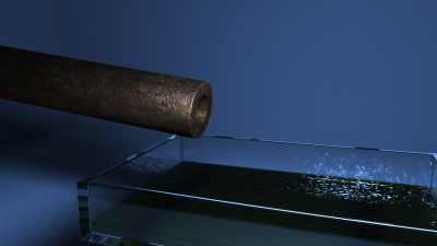

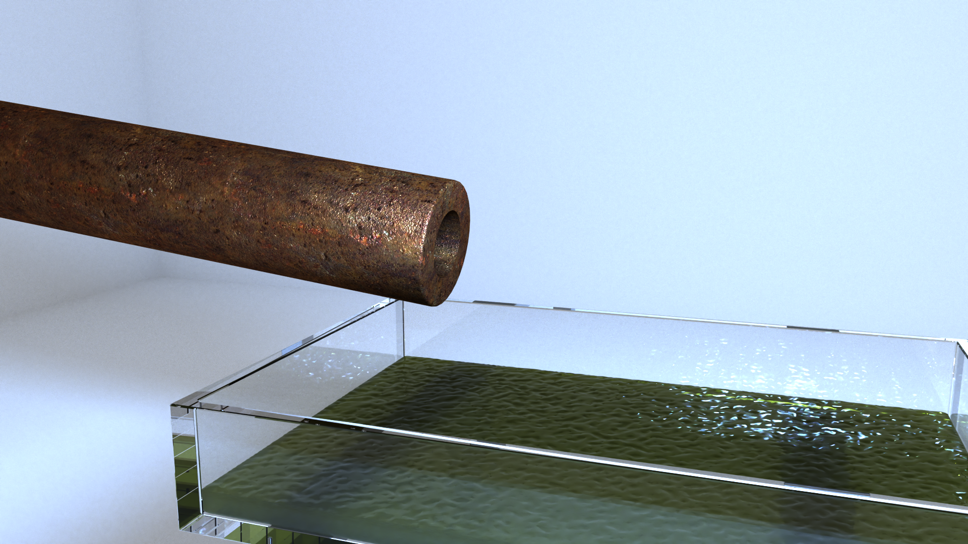

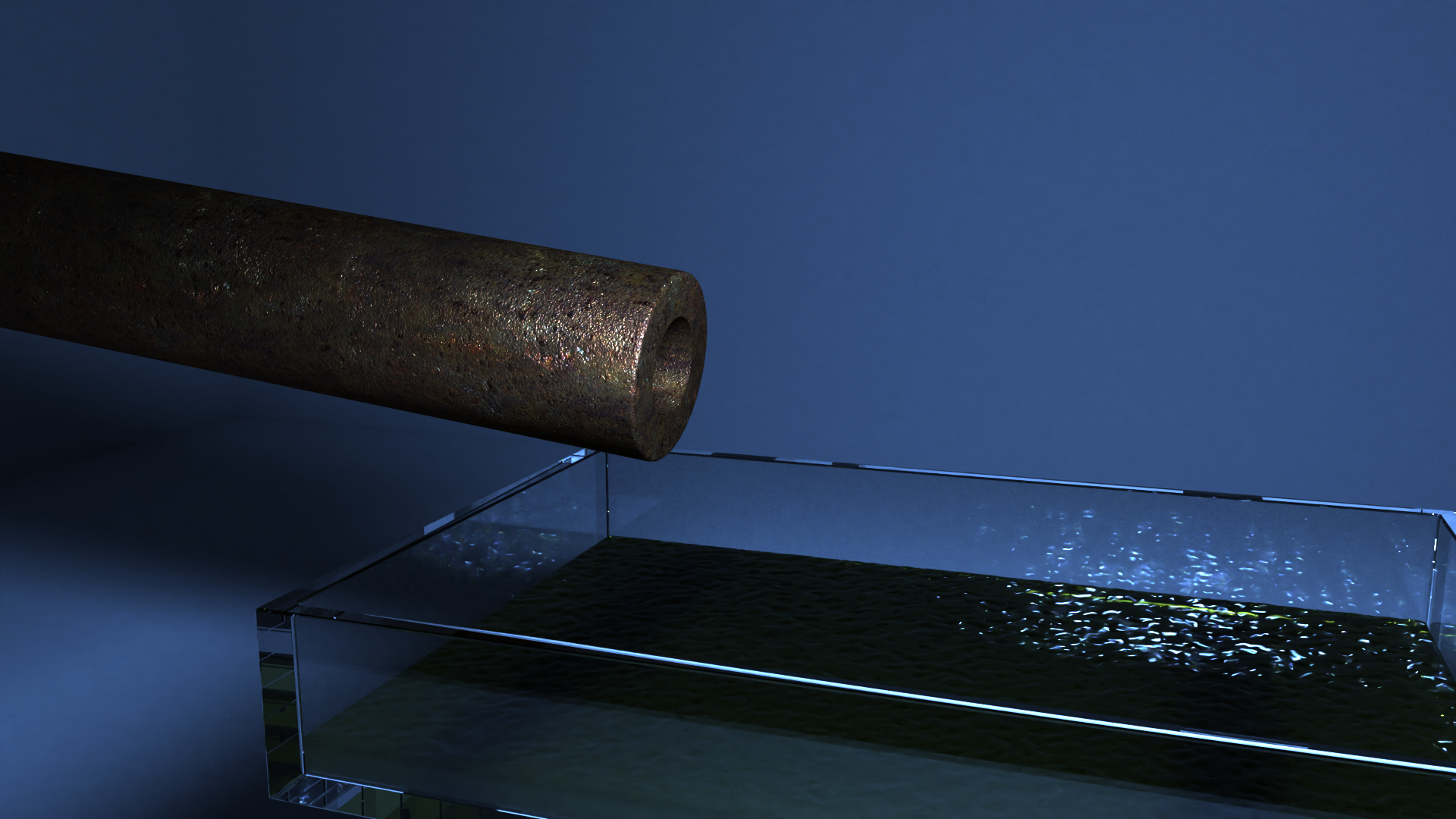

1. When i try to render an animation the light is not correct from frame No. 2 on.
The first frame is fine then the second to color is complete broken.
I try to render from second frame on then from 3. frame on the colors are wrong. I get crazy.
I tried so many things and no change. Even when i change the kernel same problem.

The first problem is very probably due to the fact you should set your Blender Color Management settings properly.
In general I keep all settings to None/Default and only use Octane Imager to manage the color correction. I hope this helps.

1. Make sure that you haven't (accidentally) keyframed you light settings, and/or the scale/position of light sources (if you have any). And just double check you light settings in general.
