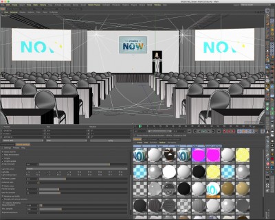

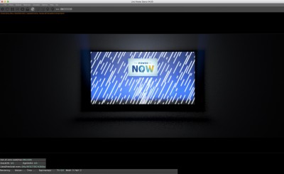

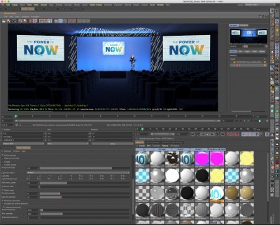

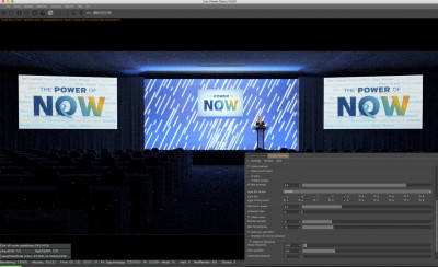

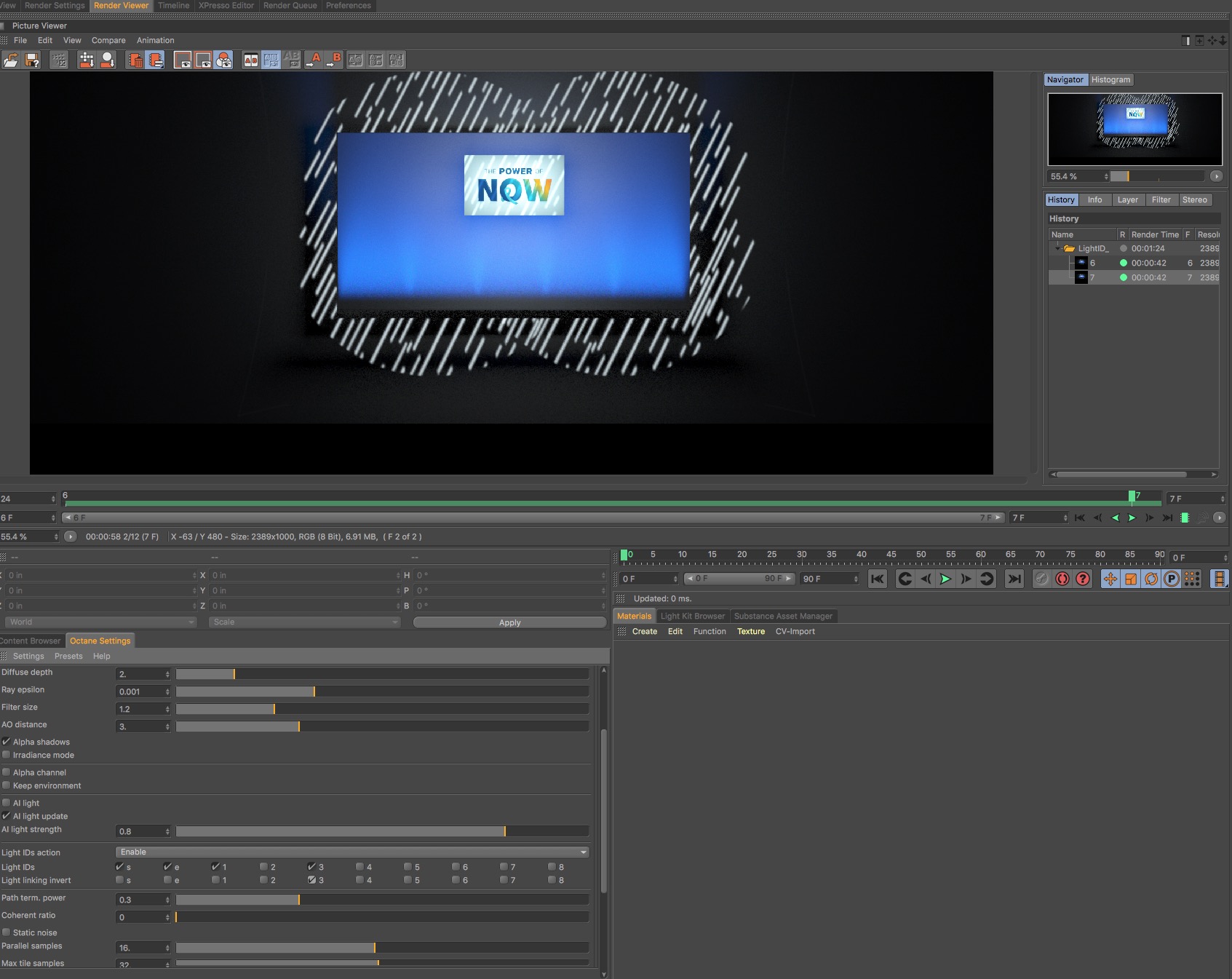

I can not get the Light ID's to hold between live view, render and re-open.
CORRECT - Live View (White light only appears on the Blue Wall)
INCORRECT - Render View (White light appears on everything but the Blue Wall)
INCORRECT - Close and re-open file (Light IDs have completely changed on there own)

Nobody could help you without a sample scene and are you sure it's a bug? So pls a scene as noted.
What do you mean am I sure it's a bug???? When I render to the Live Viewer it renders one thing and when I immediately press render to Picture Viewer it renders differently. what else would it be... This occures on any file that I build using Light linking Invert.aoktar wrote:Nobody could help you without a sample scene and are you sure it's a bug? So pls a scene as noted.
Scene: https://www.dropbox.com/s/sn738y2tq3cts ... D.zip?dl=0
Correct (Picture viewer) Incorrect (Render Viewer)

Sometimes people tweak wrong settings and thinks that's a bug. I see that's too much.

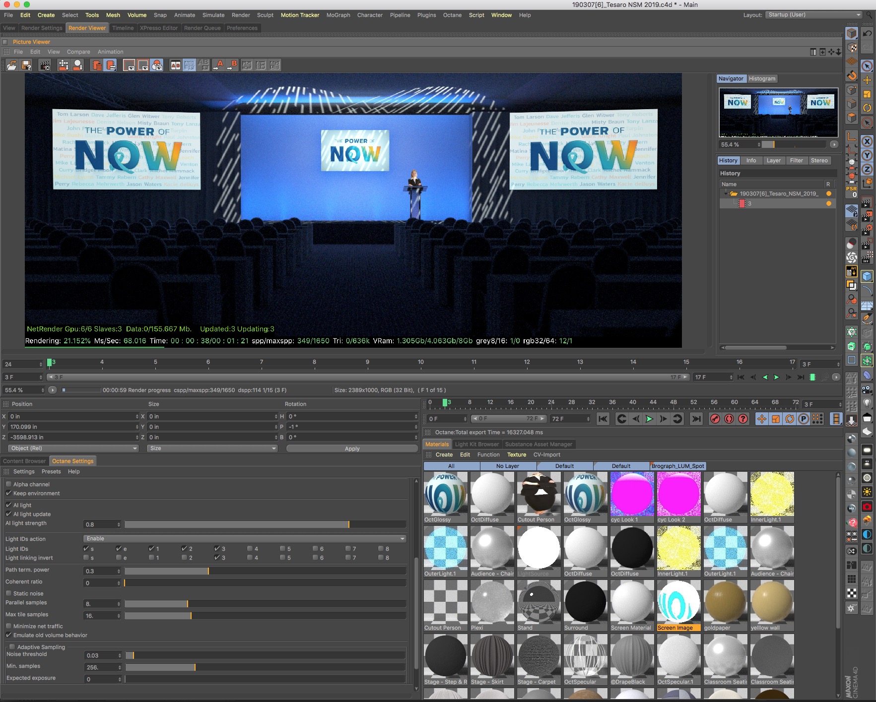

@natemac00
It looks like its because you have #3 inverted which is cancelling out the setting on the pillow wall (turning it back on)
If you add an Octane tag to the Plane, and then uncheck 3 on that one, while re-checking 3 on the pillow case wall, it renders as you show in the "correct" frame
OSX 10.12.4 | Intel 12 core @ 3.33 ghz | 128 gb ram | NVIDIA GeForce GTX 1080TI | Ubuntu Linux slave with 3x 1080ti
This works if I'm only dealing with 2 objects(which is how I sent the test file to simplify things).... But if you look at my original post it's an entire room of objects, I'd have to add a tag to every single object and uncheck #3 to all of them.niestudio wrote:@natemac00
This also doesn't explain why when I render to live the live viewer I get one thing then the picture viewer I get another.
You can see in the below video that there is no reasoning for when it chooses to work or not.
Screen Capture: https://www.dropbox.com/s/pveun1488lw0g ... D.mov?dl=0

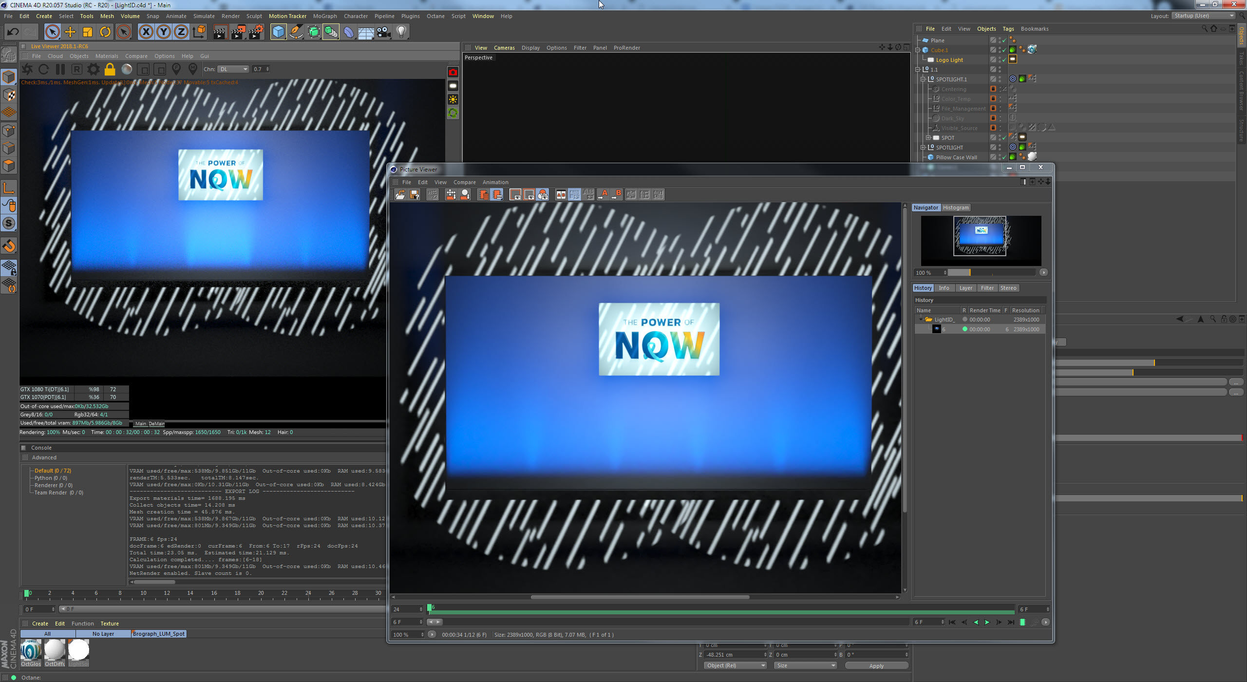

Okay but you got the exact opposite of what I was trying to accomplish, the white light streaks should only appear on the Blue Wall.aoktar wrote:It maybe due to latest build with latest c4d sdk(20.057). Now on my wip version it's working different. see image.

There's a bug with light linking invert IDs. Do you wish a fixed build? What's os?
Thank you.aoktar wrote:There's a bug with light linking invert IDs. Do you wish a fixed build? What's os?
Mac OS 10.13.6
