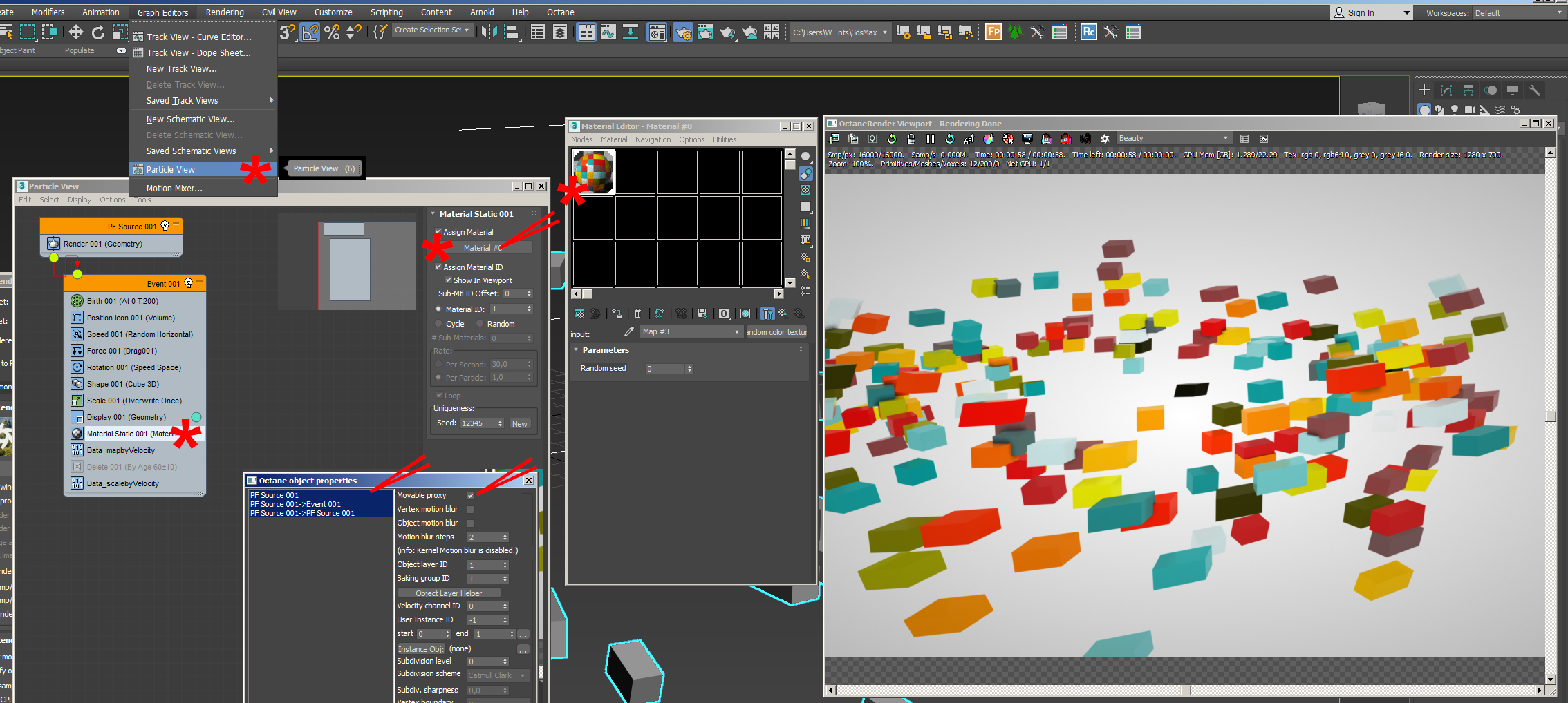

Hi everyone,
I'm trying to render particles with changing colors with octane, but I was not able to figure out how to make it. Anyone can help please
Max file is attached
Map_byVelocity.rar
(54.79 KiB) Downloaded 198 times

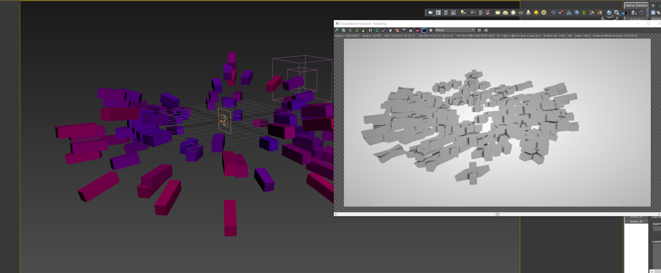

I know how to make random colors, but my question is how to make the particles changing their colors like in the attached example?

color is a problem, but it seems that geometry isn't correct in octane render viewport !!!!

HI muneers,
I'm checking some issues with it, I'm preparing a report for developers.
Meanwhile, export your sim to .abc and import it; apply gradient material with sine wave texture, spherical projection and world space.
I'm not sure it works properly, it is to be verified.
