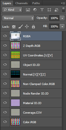

As I don't have nuke I tested ProEXR_v2.0 and Exr-IO_1.04.00 for Photoshop. (I just have cs6)
But I don't have expected results.

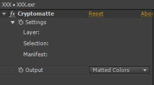

in AE, the same file don't show cryptomatte layers.

- Attachments
- CRY2.png (153.42 KiB) Viewed 5159 times

yes I saw the video, but I omit to say that AE says "No cryptomatte layer found"
oooookey !
If it can help somebody here is why it didn't work :
- I didn't read carefully enough what Paride wrote : RENDER image.... I used octane render viewport but it don't work. You need to render to have "Filename.exr" AND "Filename_MULTIOct.exr" The last one is the good one.
- If you tried a long time ago criptomatte plugins, be carefull to remove then and replace with the last one !!! I totally forgot I have old versions in AE...
Now it Works great ! (in AE cs6)
Thanks Paride, Thanks Otoy !!!! BUT lots of octane crash when rendering passes.!! It seems that RC4 resolve this. Can't wait !
