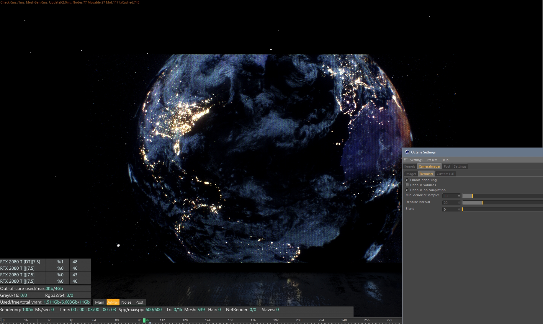

what happen if you press the Lock icon in Live View with AI Denoiser active, to render at same resolution as Picture Viewer ?
Do you mind to share a screenshot of Octane Settings/Devices panel?
ciao Beppe
FAZ
Posts: 90
Joined: Tue Oct 06, 2015 5:56 pm
Location: Miami, FL
bepeg4d wrote:Hi,
ciao Beppe
Here you go Beppe. Thanks.
V4.02.1-R2 (also done this in 4.01 stable as well- no problems in IPR)
1920 x 1080 HD I use the lock all the time and never experienced a shutdown.
Demain selected
I can scrub through the timeline at this size pretty smoothly. No problems, temps nice and low.
Quick note: Even if I create a brand new and empty c4d doc with 1 plane created and render that in the picture viewer, it still shuts off ONLY when using the denoiser. Scene load has no impact.
www.alexdimella.com IG @alexdimella

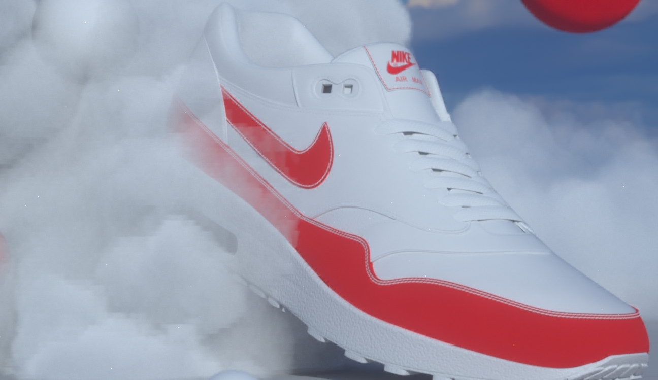

No other plugin or app is giving me shutdowns. Only Octane >animation< renders in >Picture Viewer< cause a shutdown. Rendering in standalone causes no shutdowns BUT, I do see hotpixels that were not there before. (see image) I never had any hotpixels before in this scene.
hot pixels when using denoiser in Standalone
