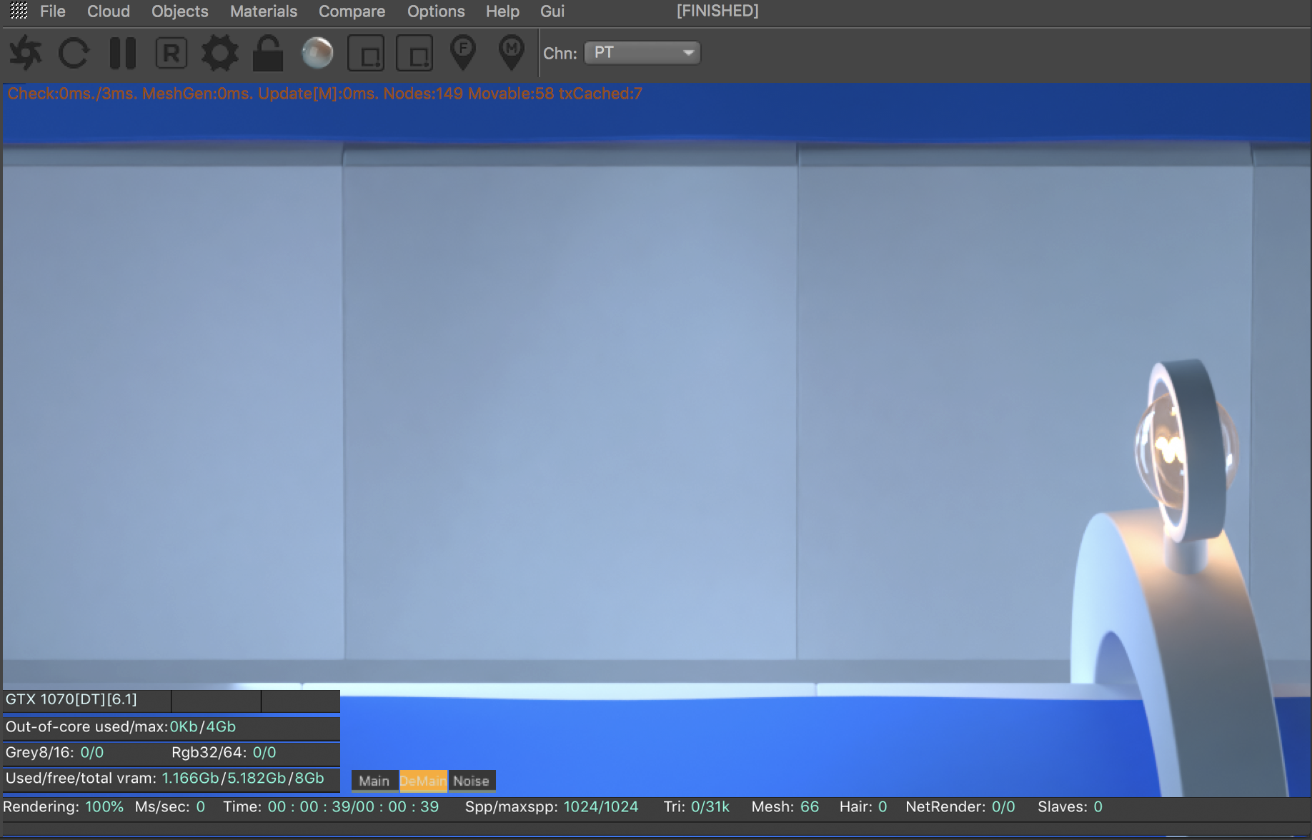

Hi, I'm kind of stuck trying to get rid of a lot of noise, firefly noisy noise, generated by a light inside a glass sphere. I've got a big lightbulb in my scene, as in a two sided glass sphere with an object (filament) inside with a straight forward emission material.
I've turned on fake shadows which reduces it a bit, are there any other settings to make the emission material ignore the glass bulb?
Lots of noise with a lightbulb setup

Here's the scene. Yeah not sure what else... I need that light to cast shadows but it can ignore the glass. Maybe a limitation on octane, i dunno?
What's weird is I have a very similar setup in another scene but the noise is a bit less, but it's still noisy. The denoiser gets rid of the fireflies in the other one but makes a mess in this one. Any ideas?

here is my attempt: I have used this technique :
viewtopic.php?f=23&t=52982&p=266457&hil ... er#p266457
ciao Beppe
ciao Beppe

ahh yes I see, good thinking, thanks for that. You have to have quite a big light with this setup but it's much cleaner. Could work for me, I'll give it a go, that thing is supposed to spin to make a flashing light so if it still flashes with such a big it light it should work.
I guess that kind light <> object exclusion is beyond octane for technical reasons as I understand it. I haven't used it much, but redshift can do this kind of thing right? not sure why it wouldnt be possible in octane. But then again I can't code my own gpu render engine so what do i know
