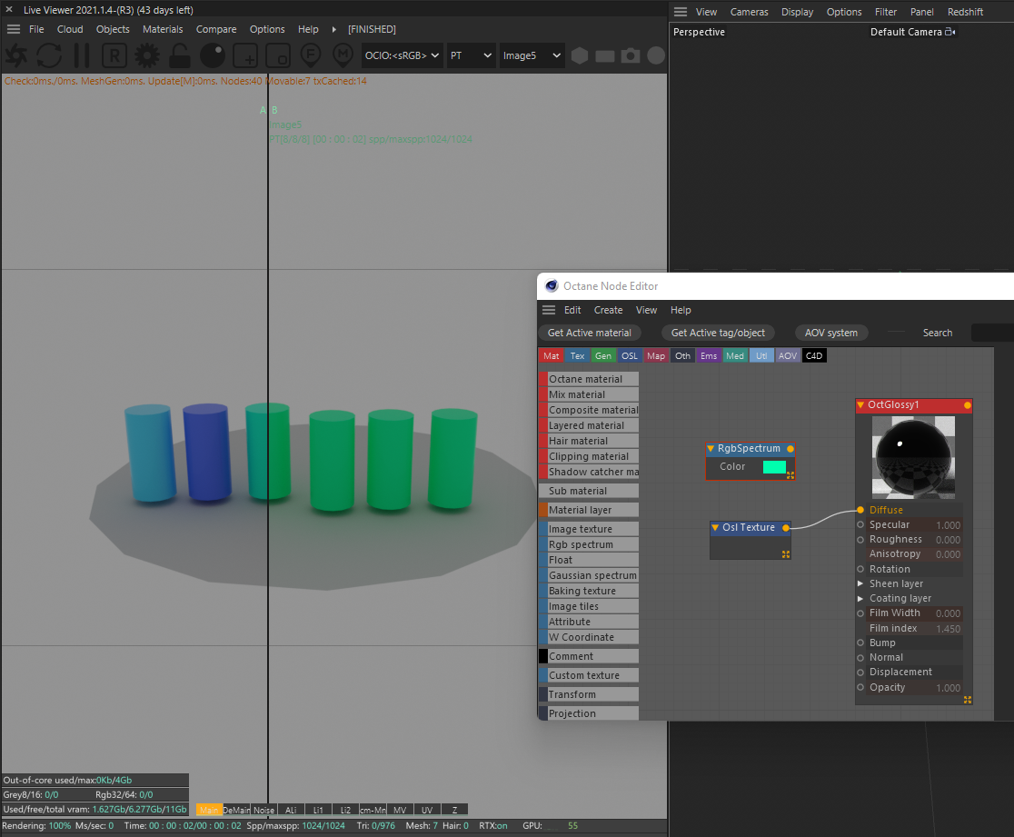

I just realized, that there is a color shift betweenn having a color defined in the octane object tag and using the osl node (or using the custom object color) and using an RGB spectrum with the exact same color. Any idea how to fix that?
