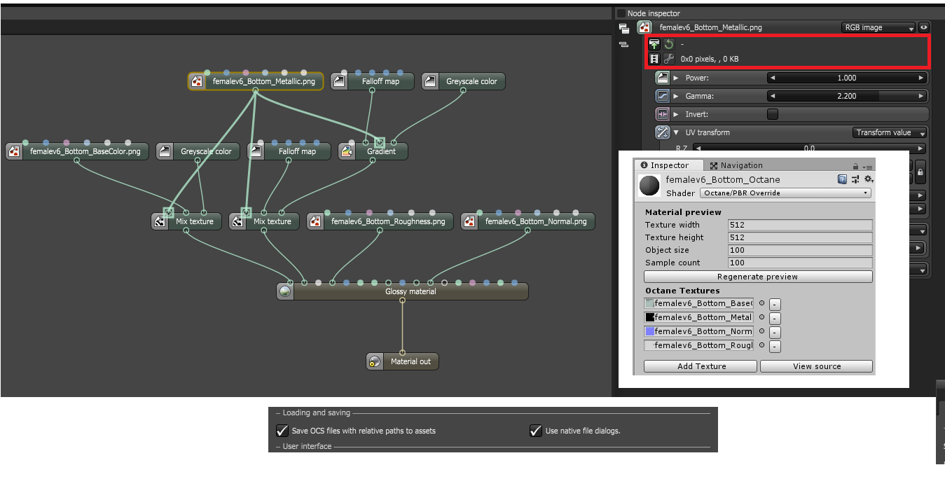

Hello again. This time I'm having problems with the textures in Octane materials.
Even if I drag the textures to the textbox or just draging it to the octane nodegraph editor directly, the path to the textures dissapear when I export the materials as a package to another project.
Can you specify why this could be happening? its a bug? or maybe i'm doing something wrong?
I hope you can help me
thank you!

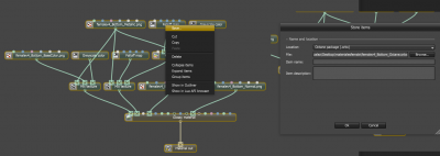

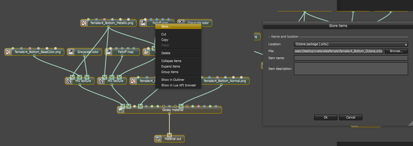

Hello. As I said on my first post, I export the materials using package export in Unity.
Rightnow I'm trying to export the materials using the .orbx export in the octane nodegraph editor, It seems to work just fine, by now.
You can see in the attached file how I'm doing it rightnow, I don't know if this is the right way to do.
Thank you!
Thank you!

This process works for me.kapitastic wrote:Hello. As I said on my first post, I export the materials using package export in Unity.
Thank you!
What was the path before they are exported to orbx?
Would it be possible for you to send me your original orbx package and your unity scene?
