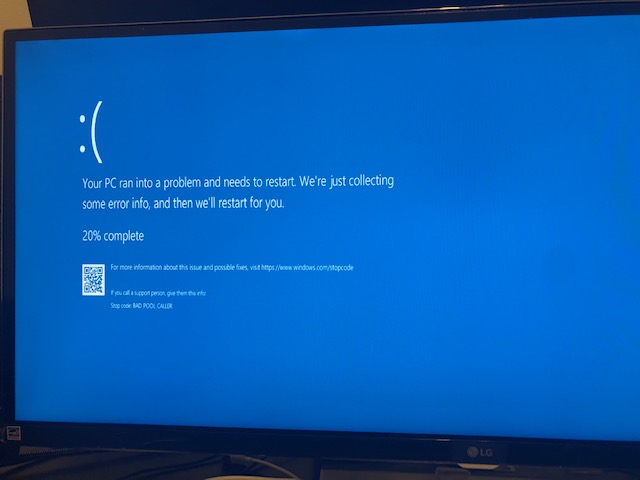

This is what happens when rendering phoenix particles with LIGHT EMISSION and AI light enabled. There is a bug with ai light and large amount of glowing phoenix particles.

phoenix particles cuda 719

Hi coilbook,
did you update the Nvidia drivers? NVIDIA 418.81 driver (Feb. 4th) doesn't work with Octane
In this case install 417.71 Nvidia drivers. To get an effective Nvidia drivers installed, please use DDU Nvidia unistaller drivers, the best way to get a clean installation.
http://www.guru3d.com/files-details/dis ... nload.html
Let me hear from you.
Regards
Paride
