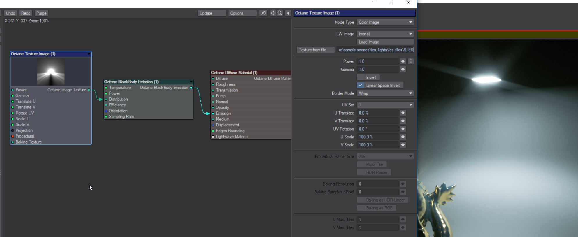

promity wrote:But IES files cannot be loaded into the Texture image module. Only images.
Yes, the IES files can be loaded using the texture image node. You should even get a preview of the IES lighting in the same node, as you can see in the attached image.
Thanks,
-Juanjo
promity
Posts: 363
Joined: Sun Dec 19, 2010 7:59 am
Location: Russia
wOW! Oops )) Thank you.

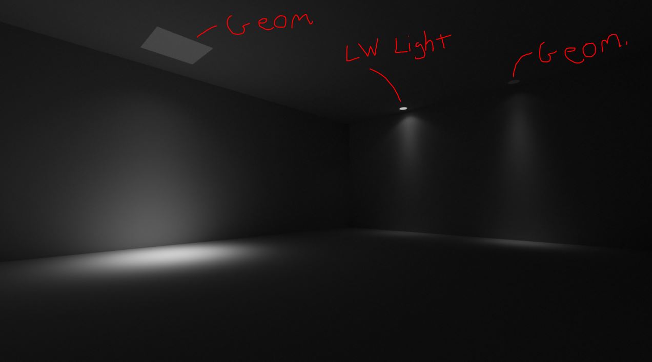

So testing this out I have some questions. One, how would you get the light geometry to glow bright? Some IES files make the geometry light up and others do not. Attached is an example of both LW lights and Geometry sized the same with applied IES through TEXTURE node. You can see the LW light is glowing white and the geometry is emmiting light but the geometry is not bright. I applied a UV map that fills the geometry for each light.
Second, it seems that the calculation is somehow off a bit. Taking say a 1m DISC LW light and then scaling it down to 6" it's about .146 in scale. So I take the POWER of the light that was on the geometry light and multiply...so for instance 50 power would become 7.6 and the result is very close...but not quite the same. Not a huge deal just wonder why. I can fiddle making it close.
PS: I've attached the scene, object and IES as well for testing if need be.
