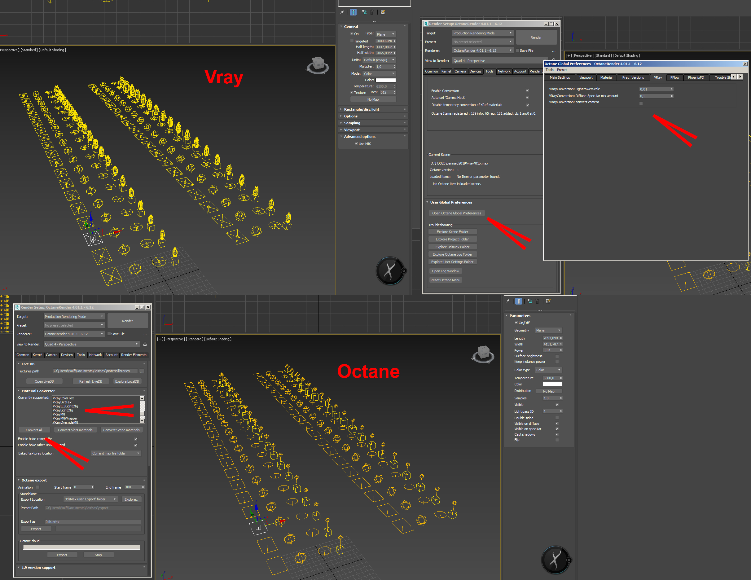

Since Octane does not have a light converter, we have to use the Vray light converter and then convert it into Octane when importing FBXs. This used to work properly, but now seems broken.
I used to be able to convert a rectangular light using this process, but now all lights are converted to point lights. They are also all pointing down now, which is incorrect.
Have a look at this scene. All the rectangular lights have been converted to points. All the lights that are supposed to point sideways now point downwards.
Another thing, I wish I could control whether the light is visible by default instead of changing them all manually. I do not usually want to show this light.
Vray Light Conversion - New Problems

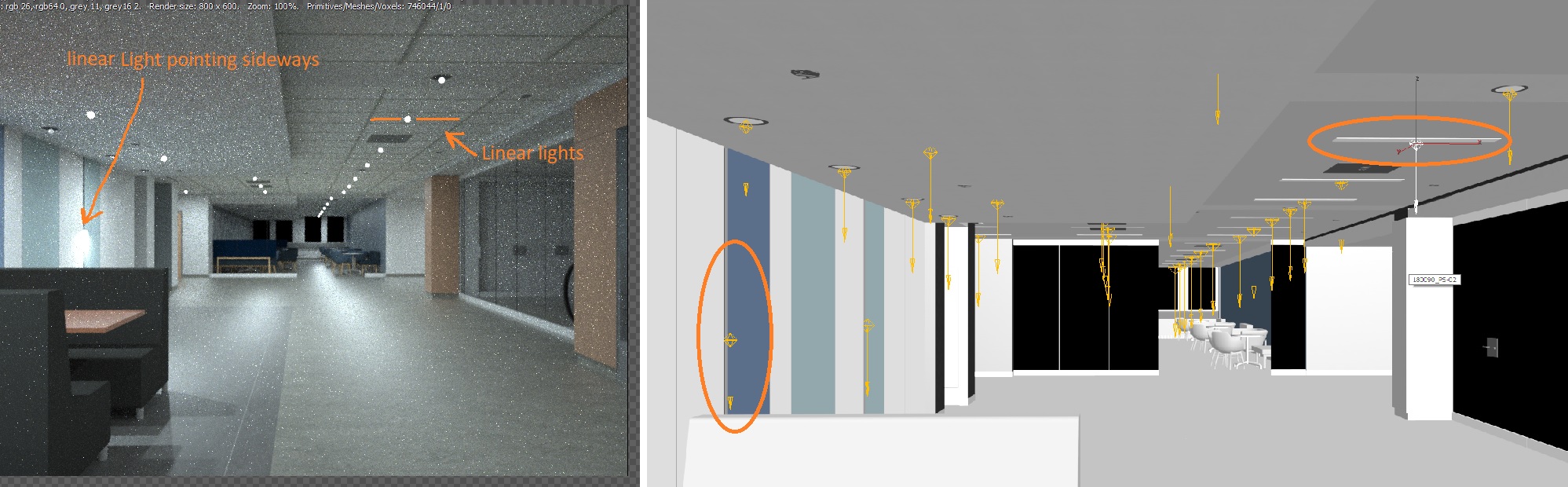

I certainly found two faults with my experience last Friday:
-The are shapes are gone and lights are transformed to point lights
-Light that do not point downwards are converted by Octane into lights that point downwards
I will try to set up a test file and screenshots when I get to work. Fro your test file, I suggest getting some files that are not pointing downwards as well.
Actually, I suggest converting a Revit file with proper lighting to see our workflow. PS- we would not be doing this 3ds Max workflow if the Revit plugin just worked with lights properly.

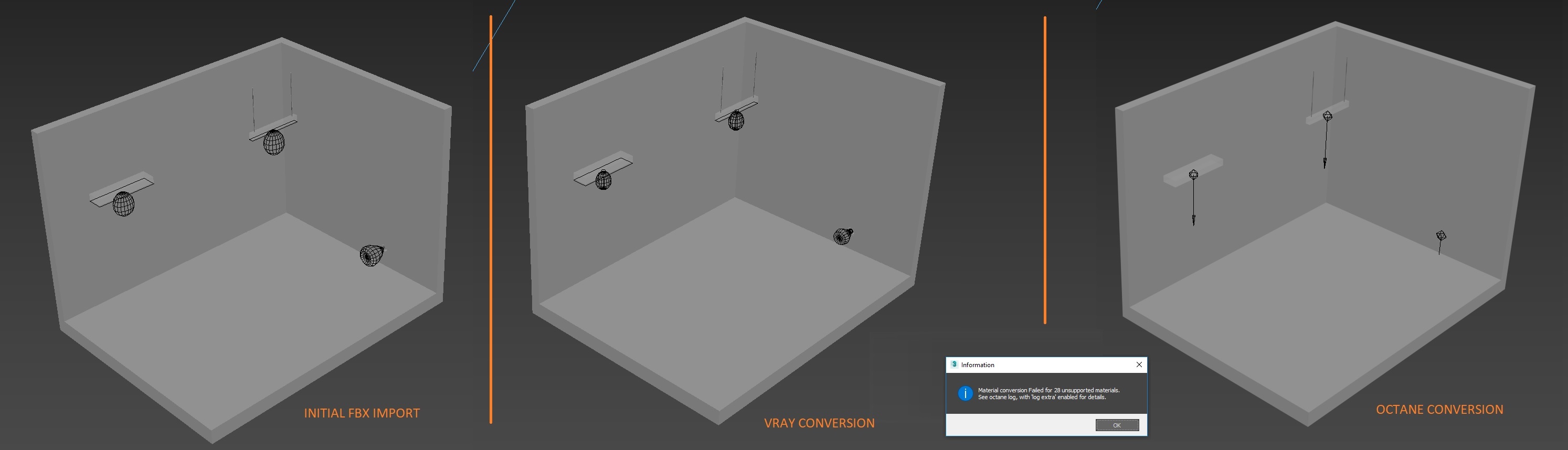

Hi Paride,
My workflow is:
-Export FBX From Revit
-Import into 3ds Max
-Switch to Vray
-Select lights and convert to Vray lights
-Using Universal Material Converter, convert materials to Standard (https://www.3dstudio.nl/webshop/product ... -converter)
-Switch to Octane and convert the whole scene materials and lights
*I wish Octane has a light converter so that I would not have to use the Vray expired trial converter*
Here are two FBXs from Revit before any of these conversions
