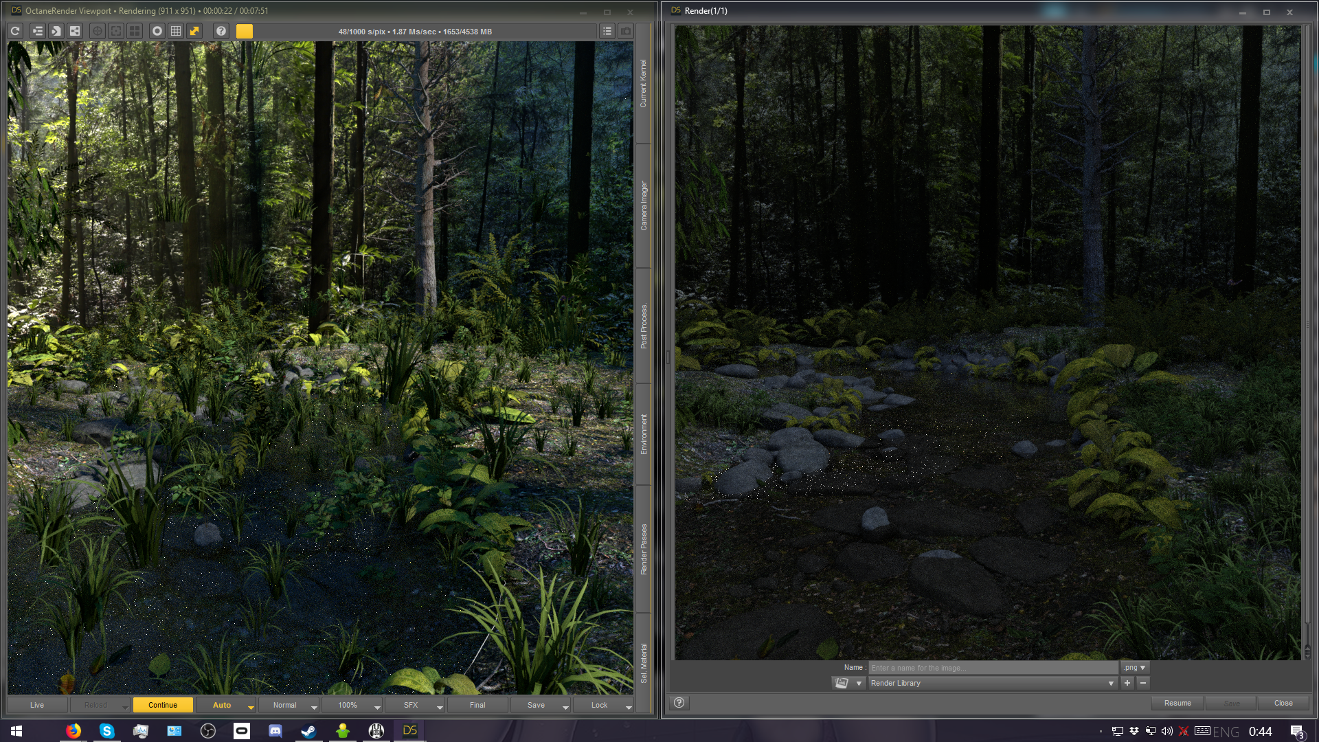

Hi! There is some scenes in my library that have a lot of instances. Octane can load the scene, but all instances are misplaced. I saw a topic about Stonemason's scenes, But in my case scene is working!
Octane Plugin version: R4.0.0.41 Subscription. DAZ Studio version: 4.11.0.231
Octane render on the left, IRay - on the right (IRay is a bit darker: I rendered it for comparsion)
Octane and DS Instances problem

Hi. If you can provide a simple scene which reproduces the instances issue, I can take a look. At a guess, perhaps there is some sort of nested instance structure in the scene which the plugin is not handling.

Sometimes I face similar problem with misplaced objects upon scene load. Selecting "Reload / Rebuild Scene" in the Octane Render Viewport usually fixes the issue (at least for me).

I tried to recreate the situation by myself, but everything went very good. I found that the only scene I have problems with is a "Fern Lake" by Stonemasonface_off wrote:Hi. If you can provide a simple scene which reproduces the instances issue, I can take a look. At a guess, perhaps there is some sort of nested instance structure in the scene which the plugin is not handling.
Paul
As it is the case with every other Stomemason prop, where instancing comes built-in with the prop.I found that the only scene I have problems with is a "Fern Lake" by Stonemason
The OCDS plug-in (to this date) hasn't caught on to the UltraScatter shnnanigans Stonemason is playing, designing his props.
Would be great to see this getting fixed some day.

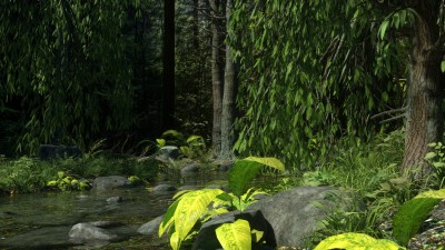

However it results in an insanely large number of objects seriously slows Daz. Turn off 'visible in view pane', and 'selectable in view' for all the converted instances.
The Octane plugin is another concern. Do not use the plug in without taking some precautions and being careful. (It renders fine, but using the plug in is an effort.)

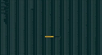

Before attempting to even look at or edit textures, make sure only a single texture is selected in materials under Scene Surfaces. Otherwise the plugin will hang forever (I gave up after 5 minutes) when the menu attempts to highlight all the surfaces using that material. There are like 1700 (?) Grass Instances in Willow Creek.
You still have to deal with horrific lists of items when you start to work the textures. Its insane. Be patient and you will get through this.
Save Often, and double check that you only have one material visible under Scene Surfaces.

Thanks for posting this. Fixing the loading of grouped instances in the plugin is not a simple thing, and will require rewriting the code that handles instances. It is high on the TODO list.
