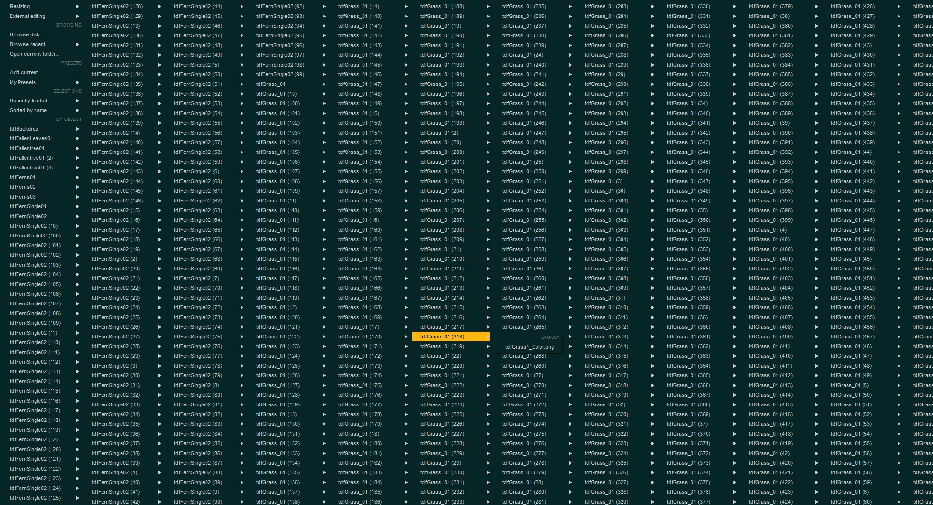

Before attempting to even look at or edit textures, make sure only a single texture is selected in materials under Scene Surfaces. Otherwise the plugin will hang forever (I gave up after 5 minutes) when the menu attempts to highlight all the surfaces using that material. There are like 1700 (?) Grass Instances in Willow Creek.
You still have to deal with horrific lists of items when you start to work the textures. Its insane. Be patient and you will get through this.
Save Often, and double check that you only have one material visible under Scene Surfaces.
Insane item lists in the plug in!
