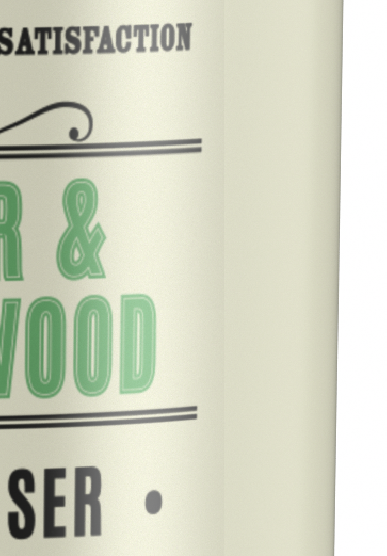

I'm rendering a label and I have an hdri environment which does the job nicely, but I need a little more light on the right, so I added an area light.
When I render, there's a distinct line vertically I can see in the label. I can't seem to get rid of it apart from not using the additional light.
I have tried all the options in the light tag but I can't figure out what's causing it. The label has roughness so shouldn't show the edge of anything or any sharp lines.
Can anyone help please?

are you sure its not the edge of your light?

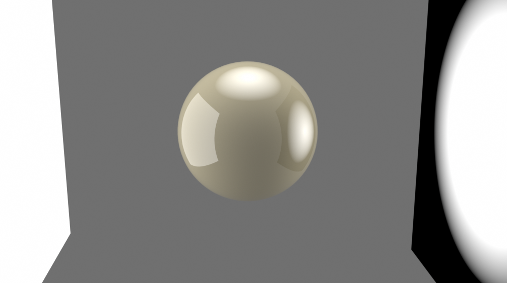

you should be able to use a technique similar to whats described here to make a softer light.
Left is a standard area light.
Right has a gradient in the texture slot.
Top has a gradient in the texture slot, but general visibility is turned down.

Smaller/brighter light further away? Think about it the same way you'd do it in the real world.
