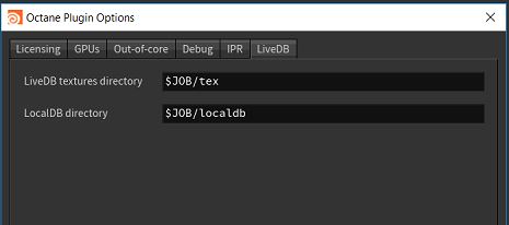

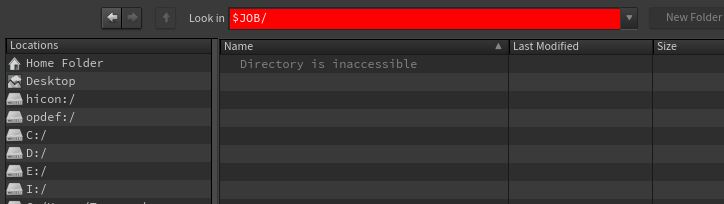

Yes thanks Juanjo, that seems to be the problem.
How could I make the directory available?
Regards.
*** OCTANE API MSG: failed to create directory "\home\aixuser\tex"
*** OCTANE API MSG: FileName::createDirectory() can be called only on absolute file names
