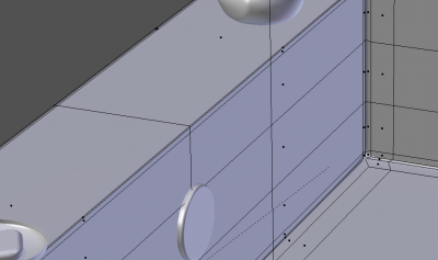

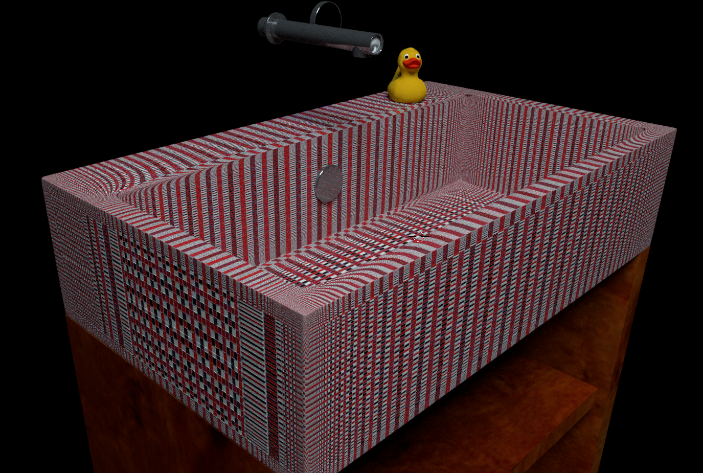

Tried now all possibilities, but can't get to proper texture on an object which I've done with extruding...
Ctrl-A and UV unwrapping don't do any changes on this mesh:
Any ideas how to fix this?

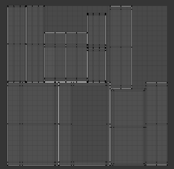

What's you material setup? How does the UV map look like?

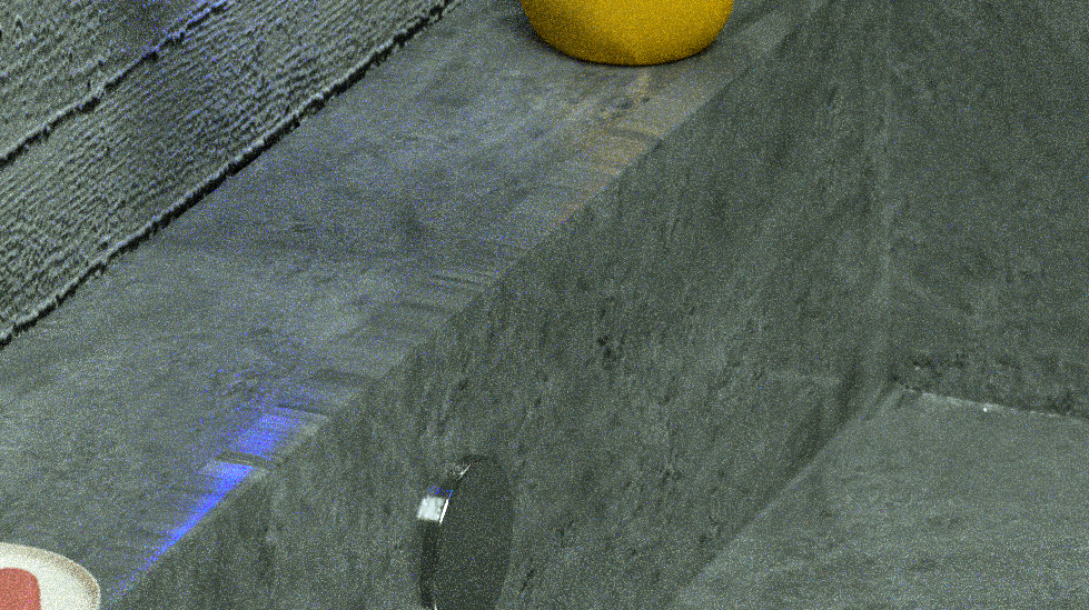

I could sort it out with the Smart UV command...though seems not perfect at some edges....looks like stretched...
The material is just from LiveDB, called polished concrete...
UVmap? There is a UVmap...but I am totally unfamiliar with UV yet ;o)
