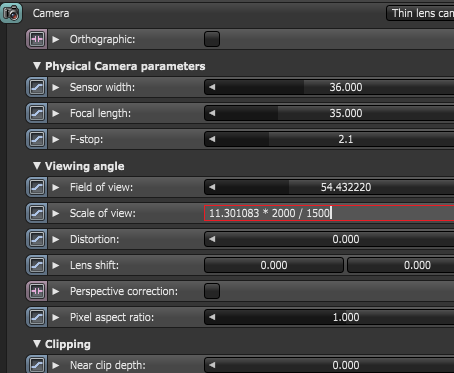

Octane will keep the horizontal viewing angle constant when changing the aspect ratio of the rendered image.
If you add horizontal pixels, you have to make the horizontal viewing angle wider, the easiest way to do so is with the ‘scale of view’ input, multiply that number with the ratio between new and old (you can type simple expressions directly into any numeric input).
