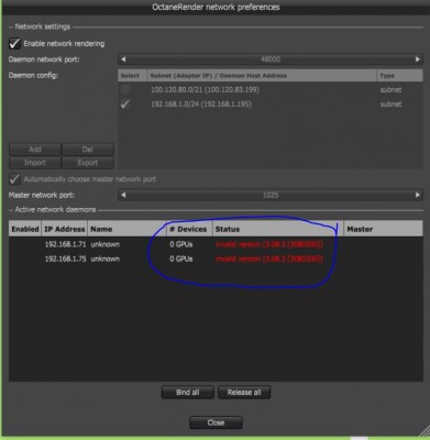

I have Octane standalone version 3.08.3 on all nodes and on the workstation with the server. I get the ‘invalid version’ error for the two nodes that I am trying to use (see attachment). Each node has one graphics adapter. I updated the Nvidia drivers but I still get this error for both nodes. The workstation renders fine by itself, but I would like to use render nodes as well. In case it matters, the Lightwave plugin is also the latest version 3 level; 3.08.0.10.
Any ideas for what is causing my issue?

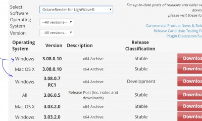

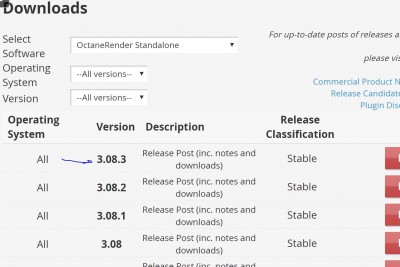

My trouble with software levels was caused by what I see in my account licenses page. It does not provide access to the latest software levels. Since I had not been in this forums for a while, I didn't think/remember the only place to find the latest level was in the forums. I figured the link/button in the account licenses list would have also provided access to the latest levels (but it doesn't).

cyborgty wrote: My trouble with software levels was caused by what I see in my account licenses page. It does not provide access to the latest software levels. Since I had not been in this forums for a while, I didn't think/remember the only place to find the latest level was in the forums. I figured the link/button in the account licenses list would have also provided access to the latest levels (but it doesn't).
Yes, sorry for that. One of the goals for the upcoming Octane 4.00 and beyond releases is to try to have always the user's customer pages download links updated with the latest plugin versions.
