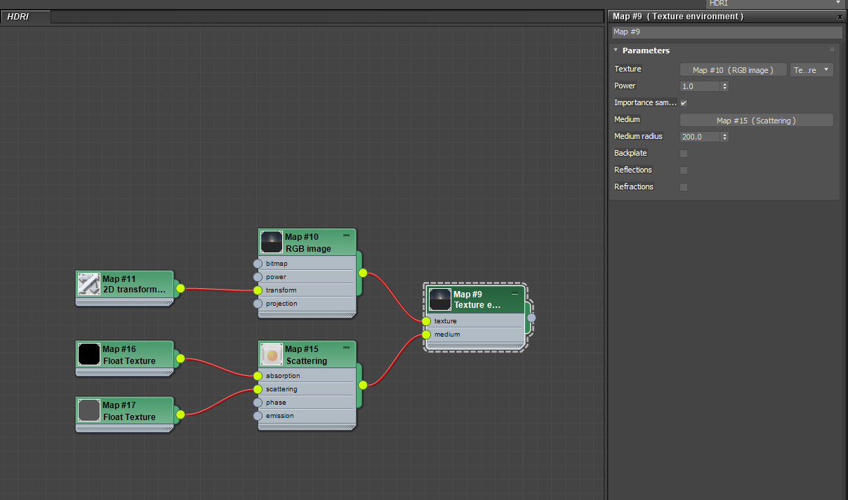

I've attached screenshot from one of my scenes, so you can have more clear understanding how to apply that knowledge to max plugin

like this it look very simple... I use octane from version 1 and I don't really look at all the node inputs :oops: Yes, there is a medium input in texture environnement node ! Thanks, I'll try :-)
edit : thank you sooo much

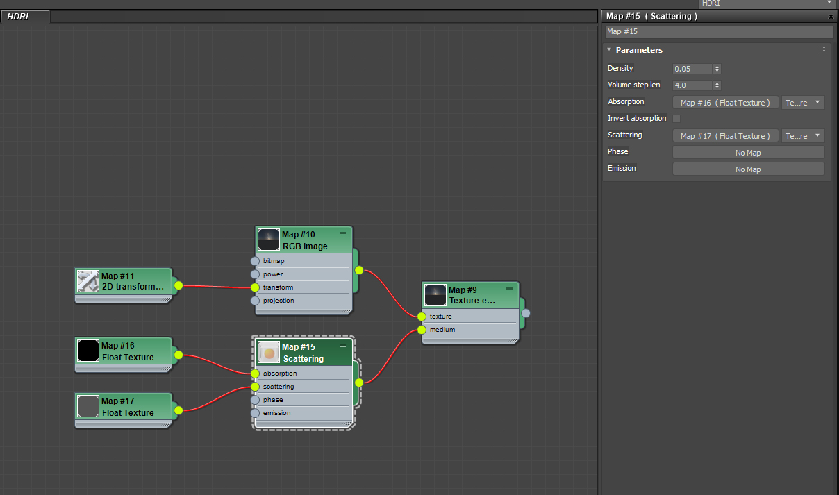

Hi i tried check every parameters finally i did it !
i think volume scattering or absor ramps dont work...
fog
fog
