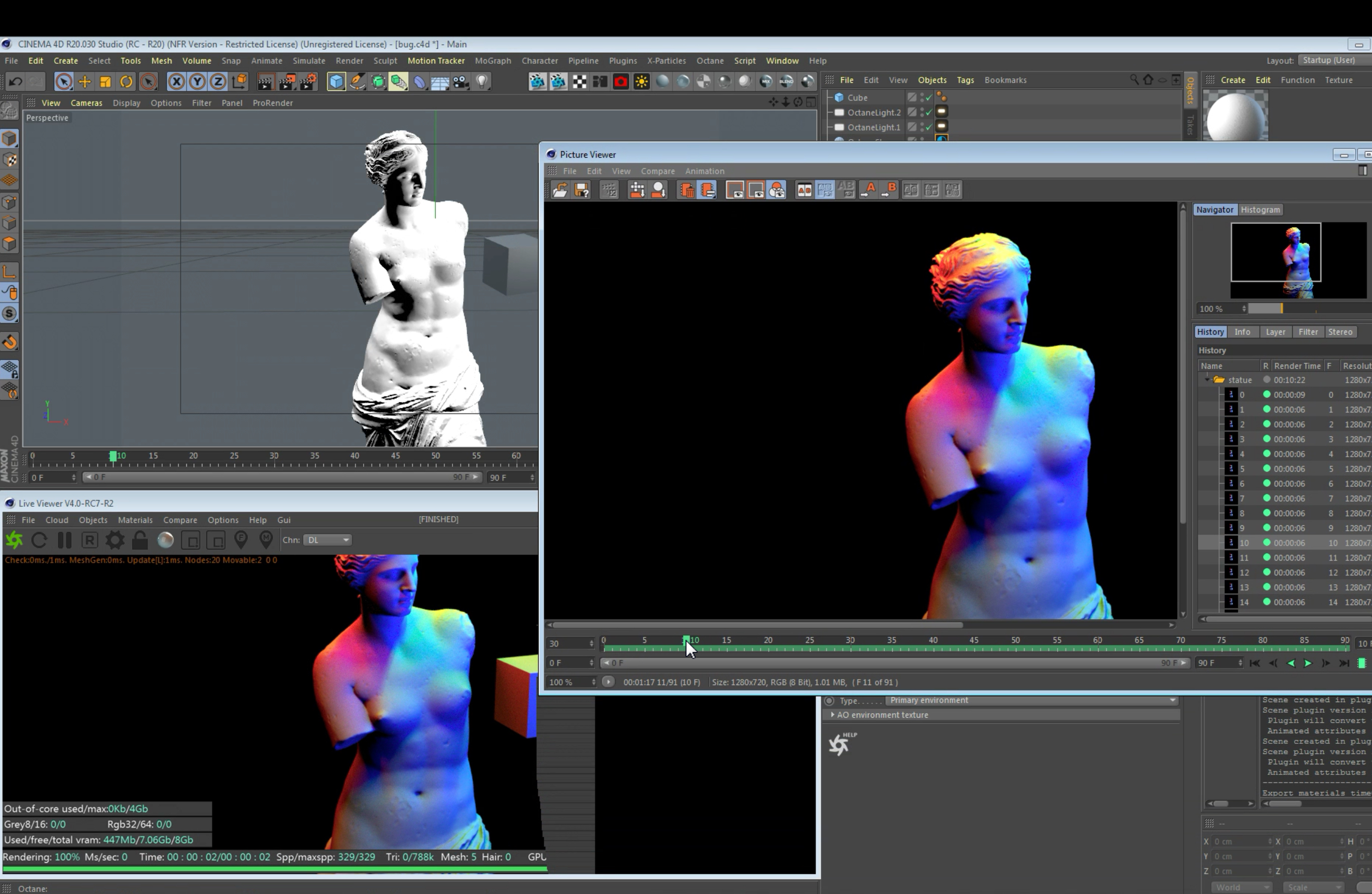

i met a lot of weird issues these days...and- will post theme after tested on latest version
in liveviewer everything fine,including animation
but,while rendering in picture viewer,some strange corrupted frames will appear randomly. the issue is definitely appear everytime
video
[youtube]https://youtu.be/R0371uByUP4[/youtube]
using v4 RC7-R2
3xGTX1070
411.63
a very simple project....
https://drive.google.com/open?id=1ZCueD ... lLhy73vAAP

Hi clarkx,
very strange, I was able to render the complete scene without issues here, and your black frames are very strange... it seems that only a portion of geometry get hidden :roll:
The only difference is that I have 391.35 drivers installed.
ciao Beppe

bepeg4d wrote:Hi clarkx,
ciao Beppe
It works!!
maybe 411 is the first release support RTX,still buggy....
after installed 416,it render fine too
