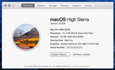

Please, go to Apple menu About this Mac and share a screenshot with us, thanks.
