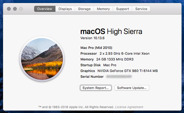

How many monitors have you attached to 980ti?
Please, go to Apple menu About this Mac and share a screenshot with us, thanks.
Then go to System Preferences/CUDA and share another screenshot, thanks.

I don't understand: it's a 6GB card (6144MB), and I'm using a single Apple Display. There's only one GPU. I'm not loading massive scenes, so where's the VRAM gone?
Also, I've reverted back to V4-RC2-R1 and it seems to be behaving itself again.
