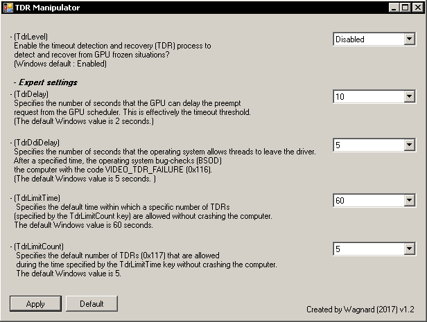

Regarding Cuda Failures, I turned off TDR Warnings, which increased stability quite a bit.
Especially on computational heavy Scenes some of the limits seem to be exceeded.
Are there any Settings to be changed, so that I can enable TDR again?
These should be the default settings set by Octane (except for disabling) right?
