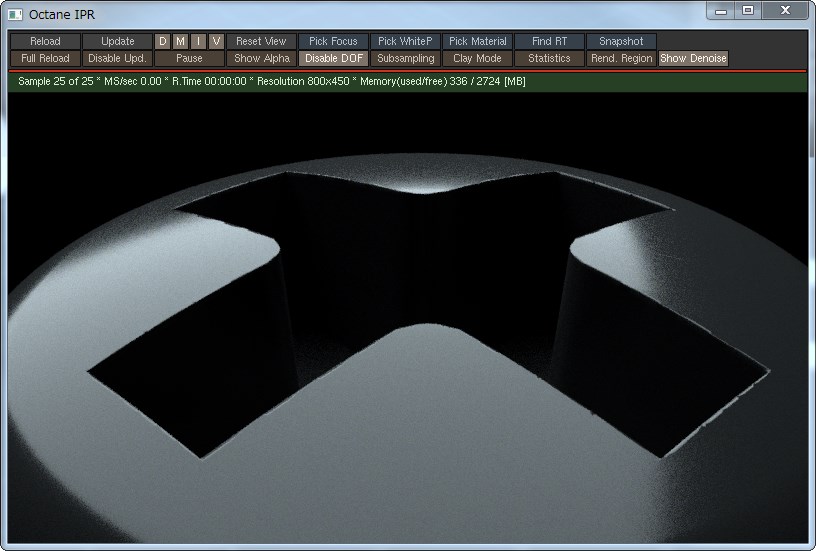

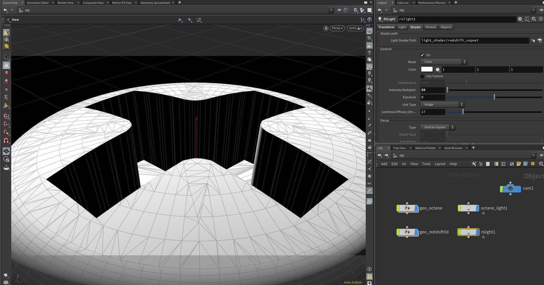

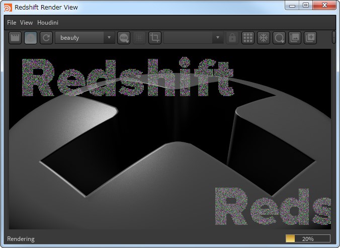

Hello,
Can Octane adjust the beautiful round edge like Redshift?
Houdini Indie 17.0.352
OctaneRender™ 4.0 for Houdini™ - beta build 4.00.0.16 RC6
Redshift Version 2.6.23
Thank you.
rounded edges problem.rar
(5.9 MiB) Downloaded 332 times
juanjgon
Posts: 8867
Location: Spain
I've reported this scene to the Octane core devs. I'm not sure what could be the problem, but I hope to know more soon.
Thanks,
-Juanjo

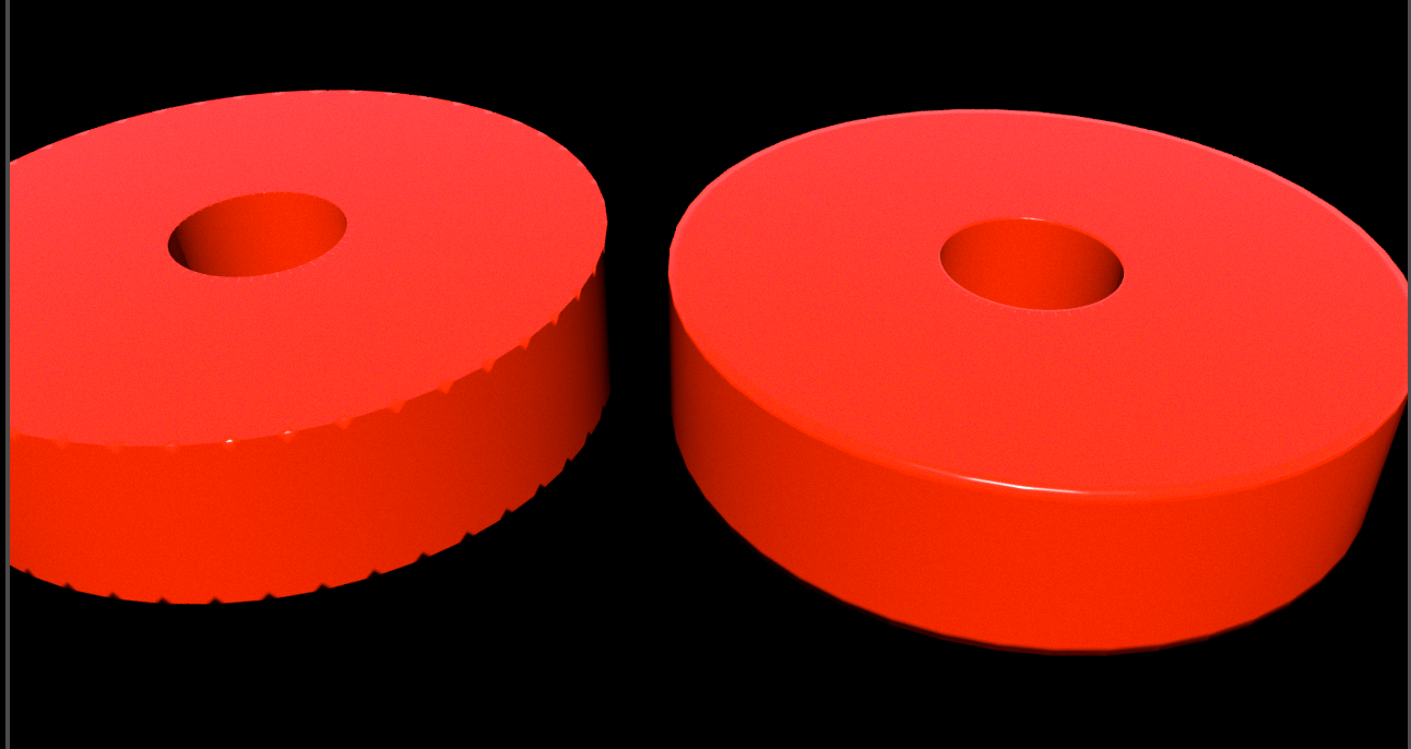

This is an ongoing issue; I have similar problems with the Octane rounded edges feature in C4D. As far as I can tell, it's a conflict between face/vertex normals. C4D's poly tools aren't the greatest, so my quick and lazy fix is to export the geometry as an OBJ using vertex normals, then reimport. There's a thread about it here on the forums from a few months ago, but I'm having trouble finding it.
For what it's worth, the geometry I build in Maya does not have this problem, but a lot of geometry built in C4D, especially the primitives, often does.
Here's a simple example. C4D tube primitive with horrible edge rounding before and after .obj export/import.
shader rounding glitches
