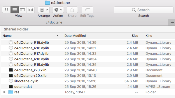

mitchino
Posts: 455
Joined: Thu Jul 14, 2016 4:49 pm
I have those two files because that's what's in the folder when it's unzipped

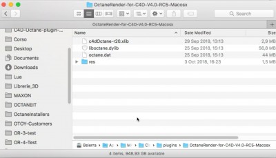

Posts: 10598
just leave only one of R20 xlib file indifferently.
The directory should look like this:
ciao Beppe
