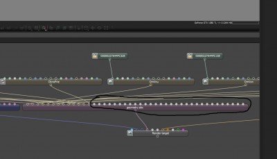

I have problem with *.orbx export,
In exported orbx is geometry.abs node with huge amount of pins.
In my test is about ten pins with materials, this is OK.
But there is maybe twenty pins Object_layer 1, 2, 3 .....,
why they are there?
This is small file, in my normal scene is perhaps 1000 pins with object layer,
geometry.abc node is 10 meters wide, ... crazy ...
help please ...

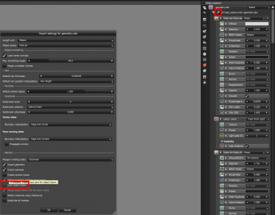

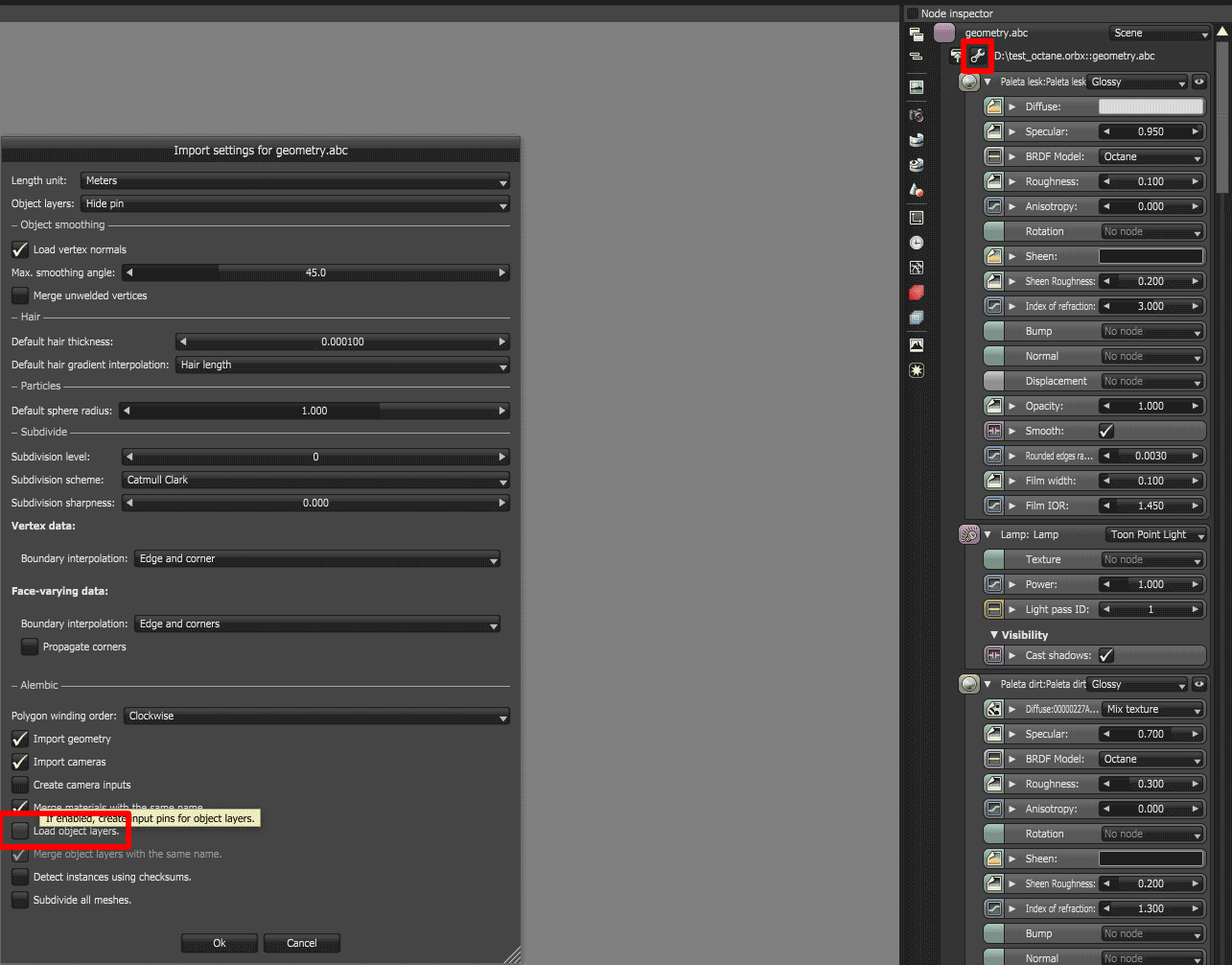

unfortunately there isn't an export option inside blender to turn off the object layers (I've asked for this a while ago).
Therefore you'll have to to do it manually inside Octane Standalone.
Select the .abc File. Go to Edit Settings and uncheck 'load object layers'.

mirobimbo
Posts: 108
Joined: Tue Dec 21, 2010 10:43 pm
Location: Slovakia
works ...
thanks :)
edit:
but after new start is is loading 3000 object layers in geometry.abc ...

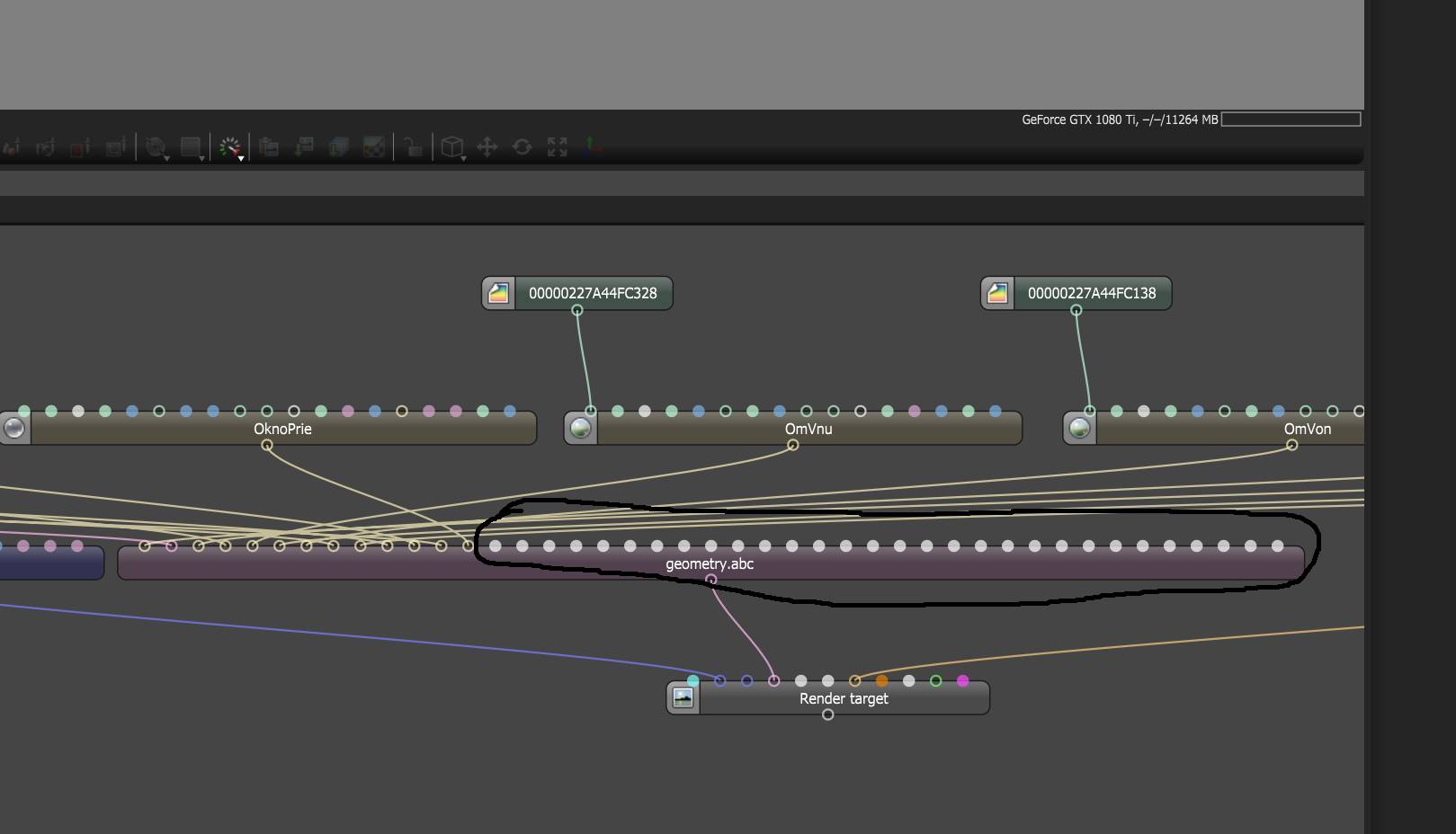

Today was new blender plugin version, "bug is still there"
It is impossible to work with node with 1000s pins object layer ...
Azen please, fix it
In this screen is 1950 pins ...
