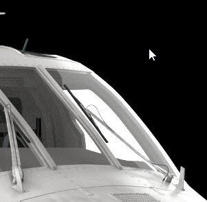

I have a complex model (glass, glossy materials, etc.) that requires a transparent background.
The lighting is a lightbox with three white discs: top, left, and right.
Sometimes I render angles with the hidden lights directly behind the model.
When I render, a noticeable white halo appears around the model including non-glossy materials.
If I untick the "Visible on Specular" checkboxes for these lights, the halo disappears, however I also lose some much desired highlights on the glossy mats. It's acting like rim lighting but it spreads to areas that I don't want.
Post processing is turned off.
How do I remove this halo?

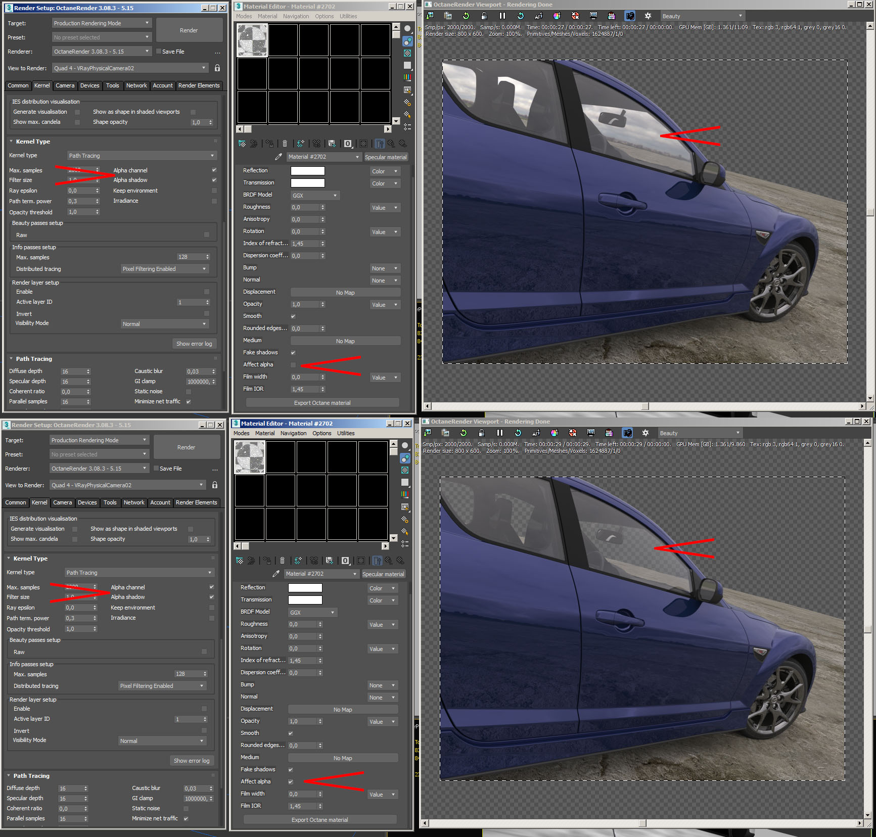

I saw your screenshot, you could try checking "keep environment" in Kernel type next "alpha channel" option.
Regards
Paride

Update. With Keep environment checked the glass in the background ends up going white. Without it, it is transparent again. I need this to be transparent.

lunarstudio wrote:Update. With Keep environment checked the glass in the background ends up going white. Without it, it is transparent again. I need this to be transparent.
Hi lunarstudio,
did you check affect alpha in specular material?
Regards
Paride

"Affect Specular" doesn't exist in the Specular Material.
Only "Fake Shadows" and " "Affect alpha" underneath my glass material.
"Affect alpha" is checked.
paride4331
Posts: 4004
lunarstudio wrote:"Affect Specular" doesn't exist in the Specular Material.
Hi lunarstudio,
I told affect alpha not affect specular.
Said that, it should work, or what I see beyond the glass, in your scene, is not evironment as I supposed.
Regards
Paride
