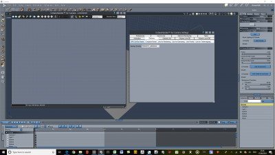

Hi Sighman,
I have downloaded the V4 build, downloaded the extra thingy needed when I first opened Carrara after dowloading, set up a little test scene with a plane and some spheres, and I'm not getting a render in the window. I have included a screenshot - there is no indication that it is recognising my GPU card. and if I open the Render Target / Devices, there is a row of buttons at the top but these don't seem to be doing anything at all when clicked - the only thing I am seeing is Render Priority.
I hope you can help!
Sighman
Posts: 1112
Joined: Thu Jan 19, 2012 9:11 am
Location: Calgary, AB
If it can’t see your card(s) then either you don’t have the latest drivers 387+ or your card is too old. Fermi (400/500) series cards are no longer supported by Octane 4.
Win8/64, I7-4770K (3.5Ghz) 24GB, GTX-980ti (6GB) / GTX-TITAN (6GB)
PhilW
Posts: 448
Joined: Fri Oct 25, 2013 9:33 am
Thanks - I updated the driver and all is good now. Any hints and tips on using the new features?
