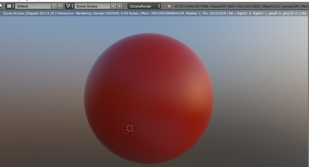

This version is compiling a single 1 mln triangles object for 20 seconds. Moving it adds another 20 seconds. This version is completely useless.

Hi J.C,

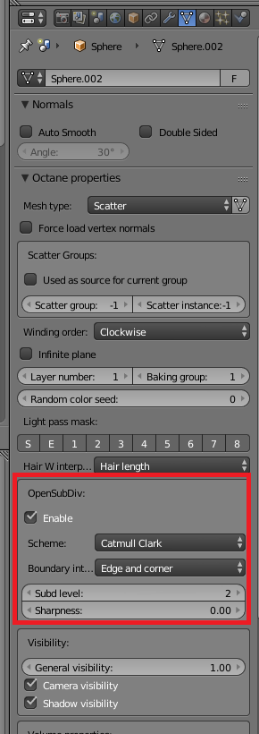

It seems that the sphere is applied with level 2 OpenSubDiv, which will lead to an extra triangle generation.
Please check the final render result, it contains around 16 million triangles while the original sphere has only 1 million. Therefore about 15 million triangles are generated on the fly, which is quite time consuming.
Regarding the orbx, it renders only 1 million triangles without generating the opensubdiv triangles. To render with subdivision triangles, you can change the subdivision level from 0 to 2 in the "geometry.abc" setting. Then standalone will take times to compile extra triangles too.

Thanks DrawFun for pointing this out! This was a false alarm, Sorry for that.
I should have checked the triangles count number in rendered viewport not in Blender viewport. Lesson learned
