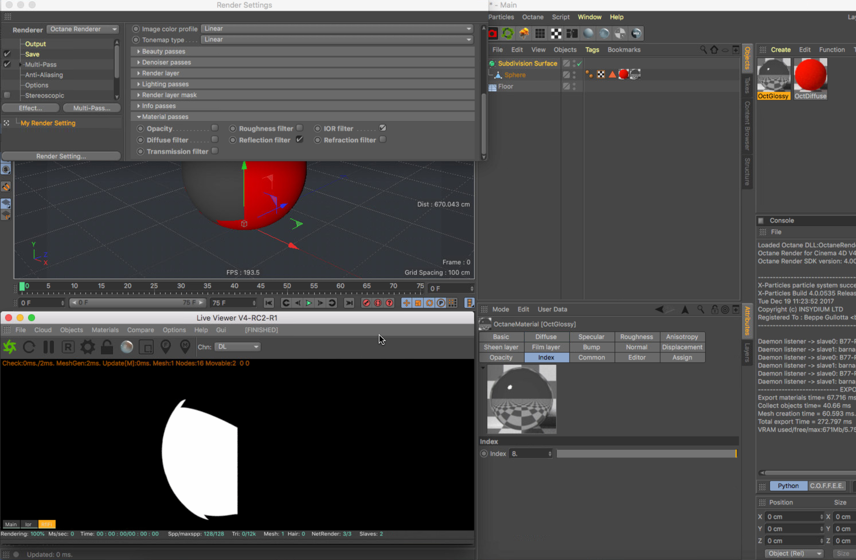

In this case, a solution is to create a take with all diffuse materials, and assign a glossy with Index 8 to the poly selection, then use the Material passes like Material Reflection,mor IOR, to obtain the mask:
You can use different IOR settings to obtain more than one gray selection.
