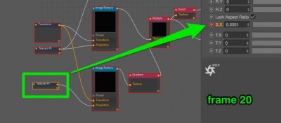

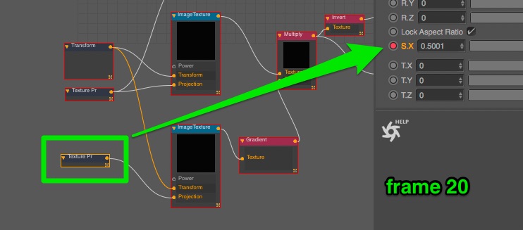

Hi Kraig,
This seems to be working:
Add the slightest of animation on one of your transform nodes.
This will give the material something else to refresh like Ahmet mentioned.
