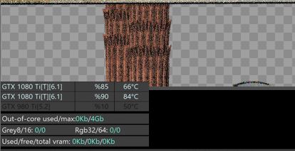

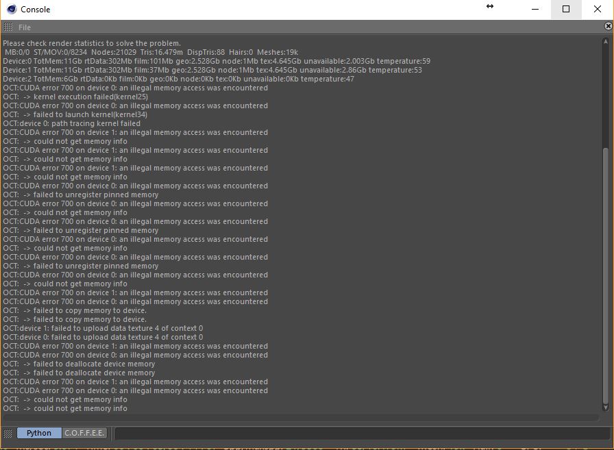

I don't know if it's a bug or not but when I have a heavy file I have every time this error(attached).
with the same PC, same drivers same file etc etc etc, but using the 3.07 it works perfectly.
I tried to google it but I didn't find a solution to this.

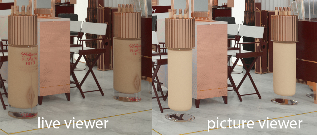

sometimes happen that if I render some instances in the picture view they are rendered wrong, while in the live view they are correct( attached)?
basically in the live view I can see the glass of the cylinder but not in the picture view
do you know this problem by a chance?

error CUDA 770 - an illigal memory access was encountered

Disable GPU with 6Gb. You may be in out of VRAM.
Hi Enzo,
please, try with 3.08.3:
viewtopic.php?f=85&t=68503
Which Nvidia drivers have you installed?
If it is the latest one, please try with DDU:
http://www.guru3d.com/files-details/dis ... nload.html
and then install 391.35 drivers, they should be more stable with 3.08/4.
ciao Beppe

Cuda errors are related with Renderer core not plugin side. Renderer is nimbly depended to Cuda part from Nvida drivers. So It can be a bug in driver or octane core.enzo_87 wrote:Hi Beppe,
it's already the 3.08.3
I'm still strugling with this problem, it seems that is not possible to put the texture in the out of core system even if it is on
You should send us a scene which produce errors. So we can investigate that!
