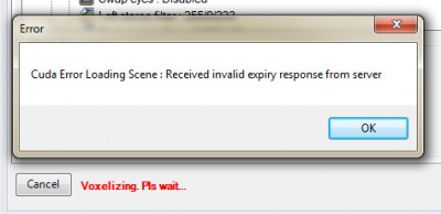

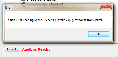

But now, with OctaneRenderForRhino6_3_08_3_94_SUBSCRIPTION and OctaneRenderForRhino6_3_08_3_95_SUBSCRIPTION, in scenes with many polygons, a cuda warning appear after the voxelizing phase.
Bye
Can you post the full Octane Log (from the Devices tab) report pls?

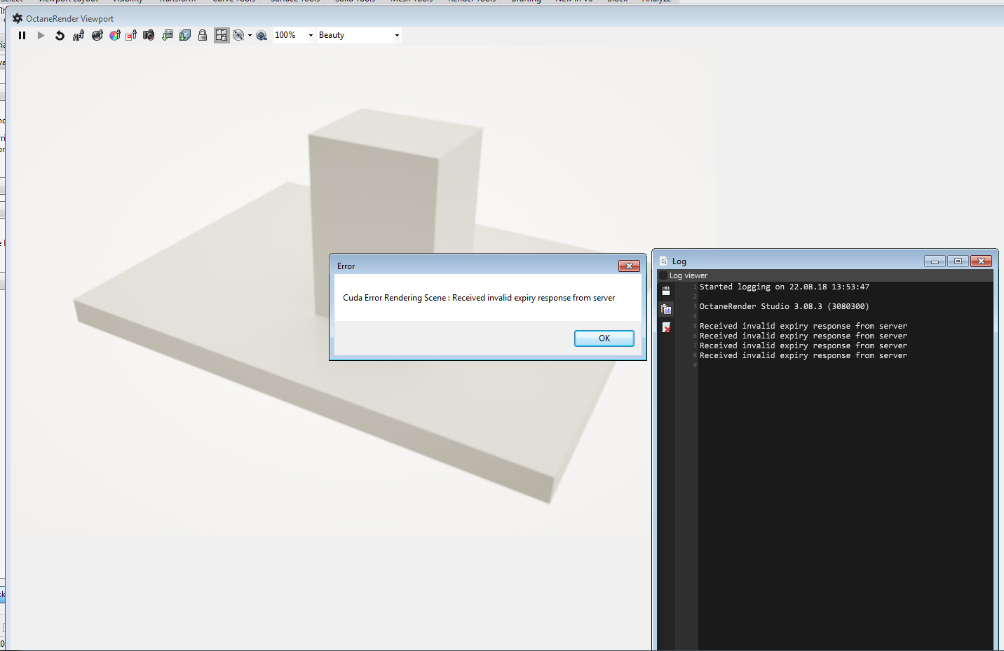

I said this issue appears only with a lot of polygons....I made a mistake. it always happens.
bye
