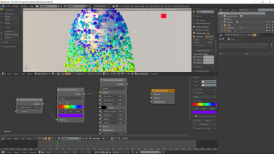

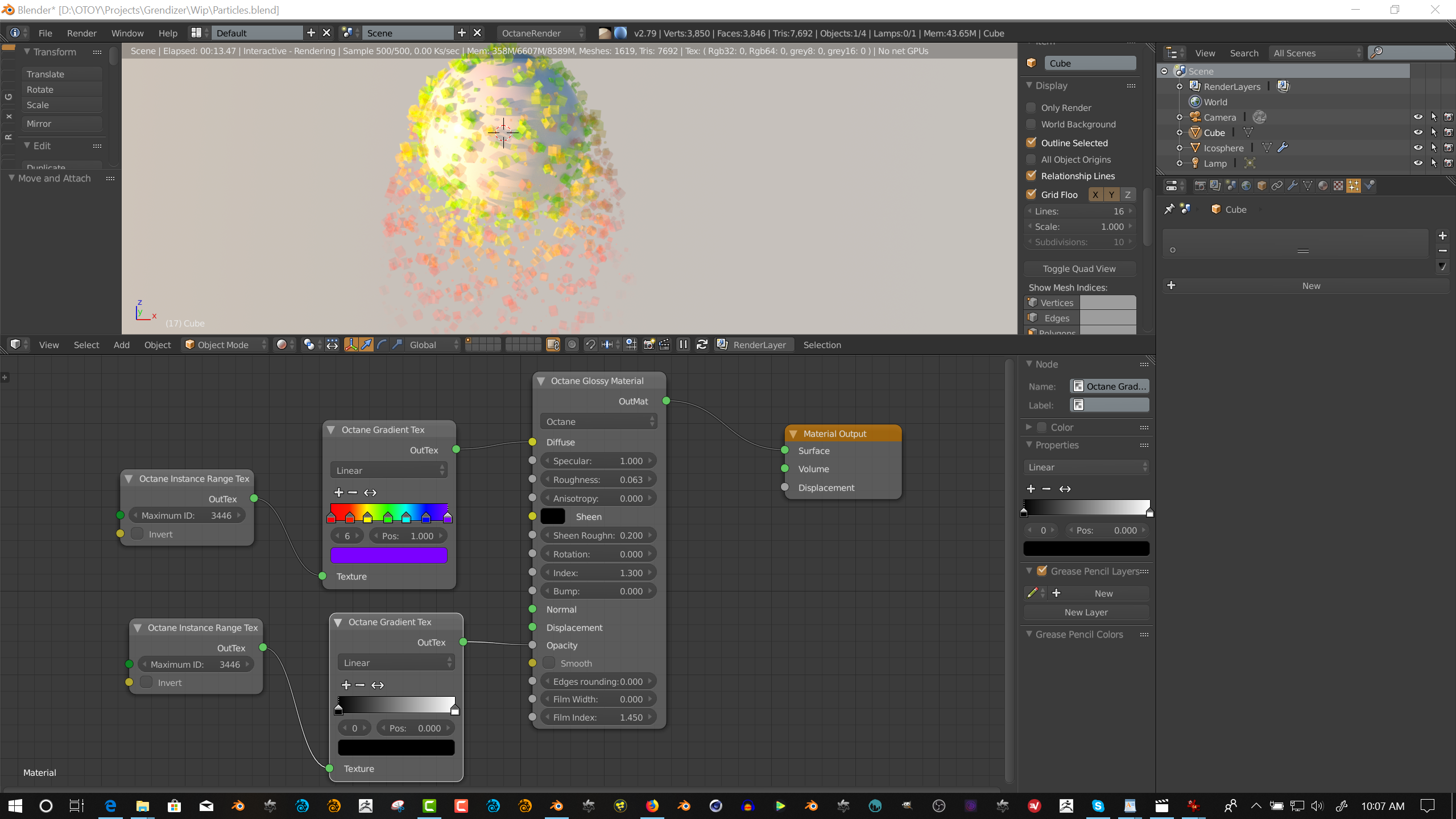

You can only use objects to render particles, but you can now change colors and opacity using the Octane Instance Range Texture node.

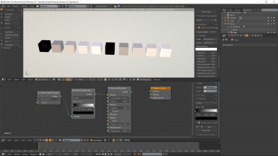

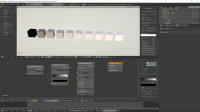

I've been waiting before posting here because there was a small bug in the Instance Range node that would have made explanations a little confusing. Now that's been fixed (the fix will be available in the next build, out soon) I can post a simple scene that should help claryfing how it works.
Each clone or particle has a specific ID when it's generated. First object/particle will have its ID set to 0, the second set to 1 and so on.
The Maximum id determines for how many particles the colors specified in the gradient should repeat.
In the attached scene you'll find a gradient that goes from black to white.
This is what happens when the Maximum ID is set to 9 (which means 0 to 9):
The color range covers all 10 clones.
This is what happens when the Maximum ID is set to 4 (which means 0 to 4):
The color range covers the first 5 clones, then it repeats on the following 5.
I hope this helps!
