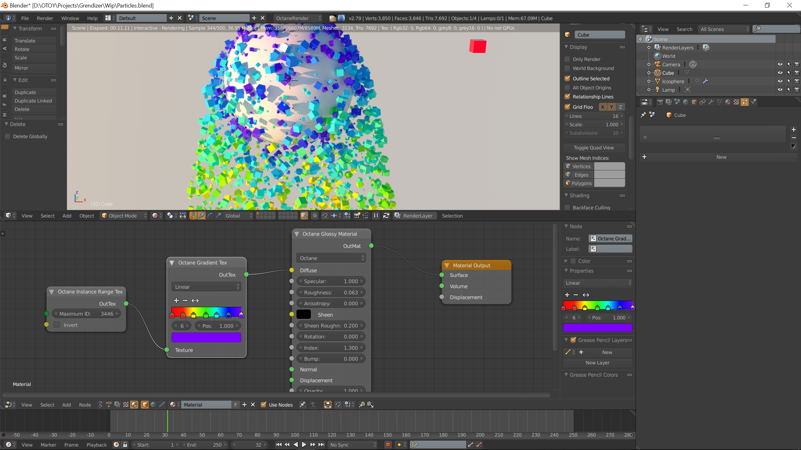

EDIT: One of the features I am looking for, is it possible to change colors, fex.random colors or in lifetime with a colorramp and make particles fade in/out - out when dying

You can only use objects to render particles, but you can now change colors and opacity using the Octane Instance Range Texture node.

linograndiotoy wrote:You can only use objects to render particles, but you can now change colors and opacity using the Octane Instance Range Texture node.
What does Maximum ID relate to? I'm unable to get this working...
Thanks.
J.C
Posts: 1880
Joined: Thu May 13, 2010 6:35 pm
Location: Wrocław
Taken from the manual:
"The Instance Range Texture is used to hold a gradient color with the range 0 – Maximum ID and prepares this range to be mapped to geometric instance IDs. This node has only one attribute, Maximum ID which should correspond to the total number of instanced geometry in the scene for which the material is applied. Additionally, the Maximum ID values can be spread out to allow a wider range of values with less instanced objects. In figure 1, the Maximum ID value is set to 50, however, there are only 4 instanced objects in the scene. Each object's Scatter Instance ID is set to a ranged sample between 0 and 50."

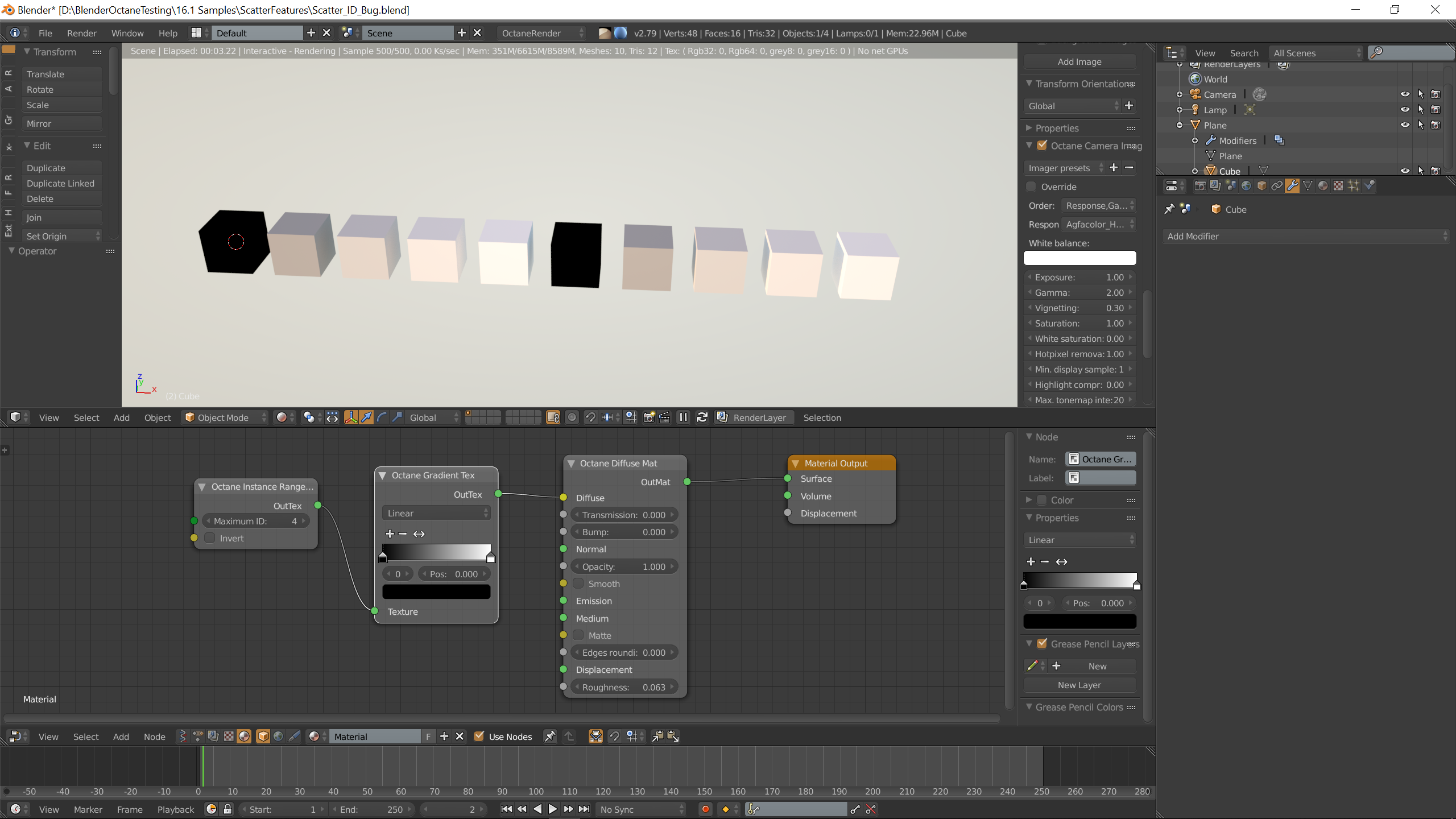

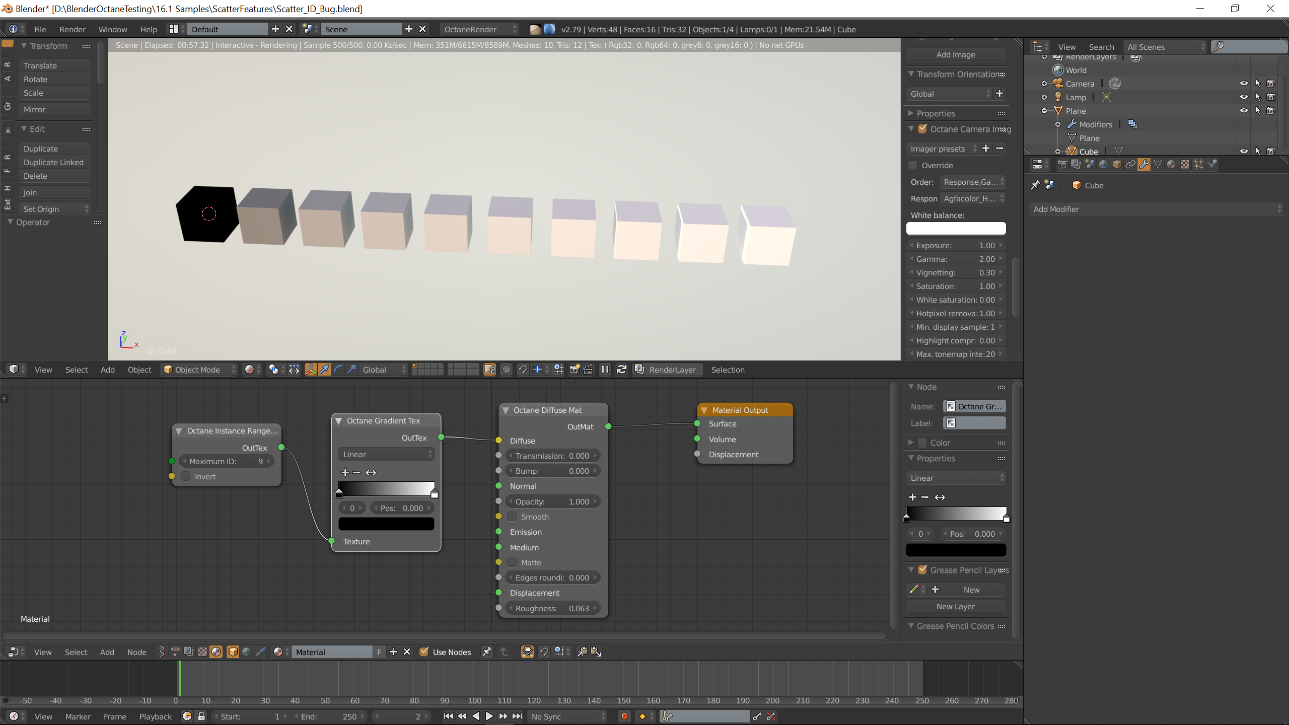

linograndiotoy
Posts: 1538
I've been waiting before posting here because there was a small bug in the Instance Range node that would have made explanations a little confusing. Now that's been fixed (the fix will be available in the next build, out soon) I can post a simple scene that should help claryfing how it works.
Each clone or particle has a specific ID when it's generated. First object/particle will have its ID set to 0, the second set to 1 and so on.
The Maximum id determines for how many particles the colors specified in the gradient should repeat.
In the attached scene you'll find a gradient that goes from black to white.
This is what happens when the Maximum ID is set to 9 (which means 0 to 9):
The color range covers all 10 clones.
This is what happens when the Maximum ID is set to 4 (which means 0 to 4):
The color range covers the first 5 clones, then it repeats on the following 5.
I hope this helps!
