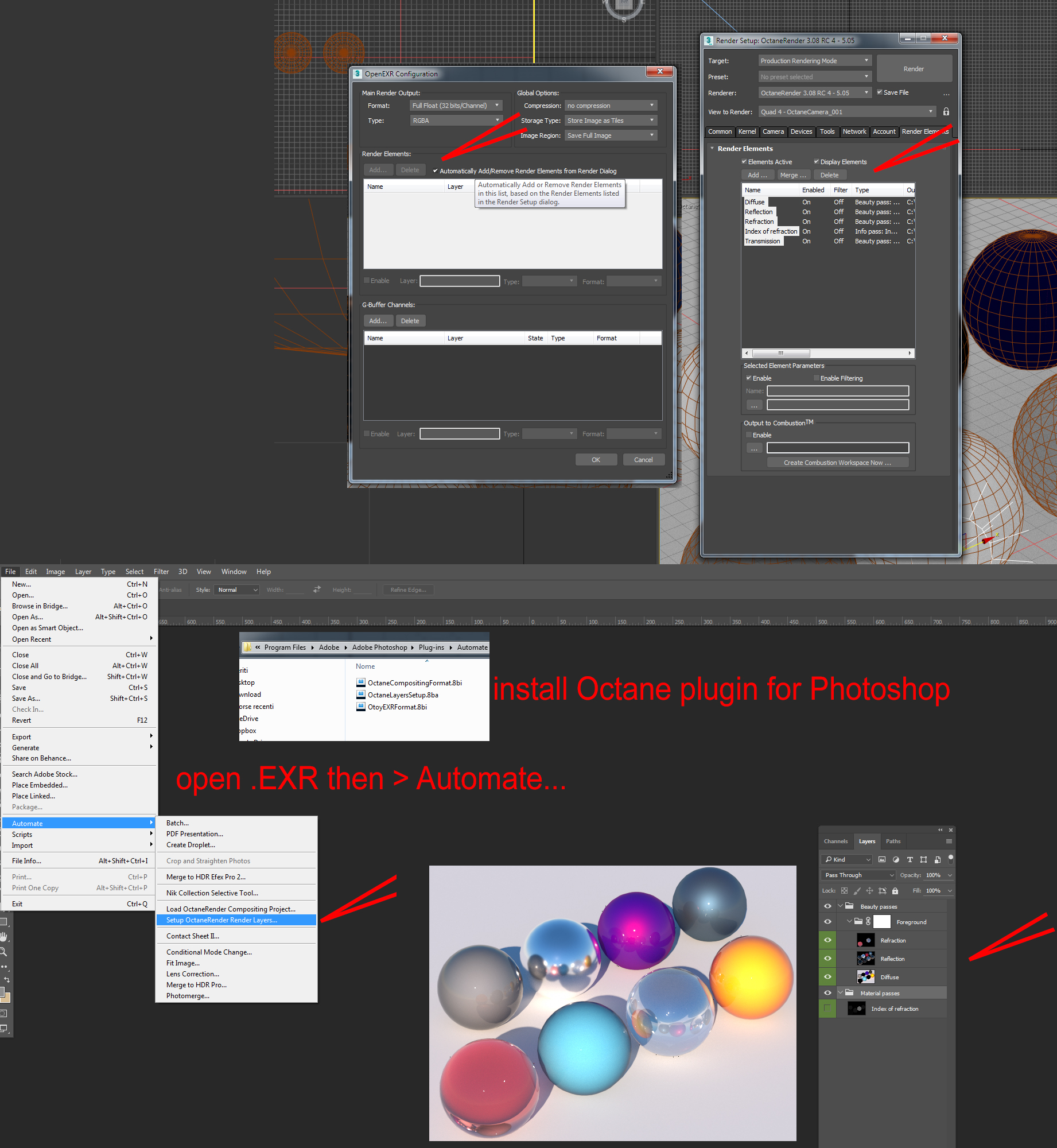

Hi Norman_Stansfield,
I hope it helps.
Regards
Paride

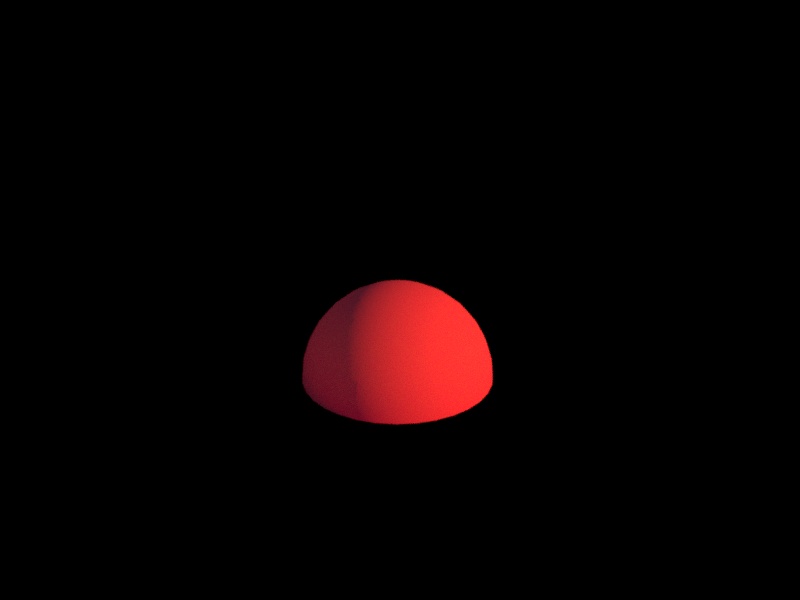

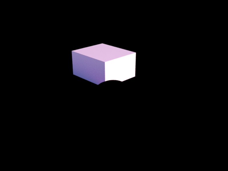

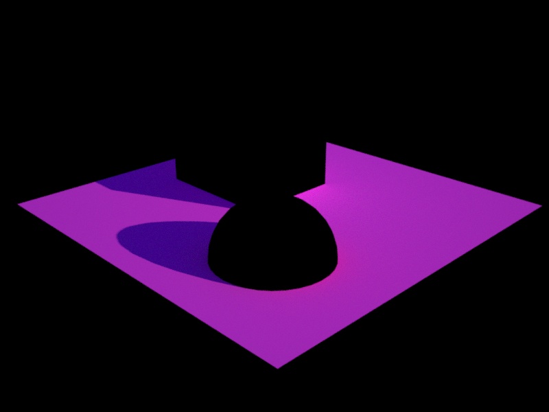

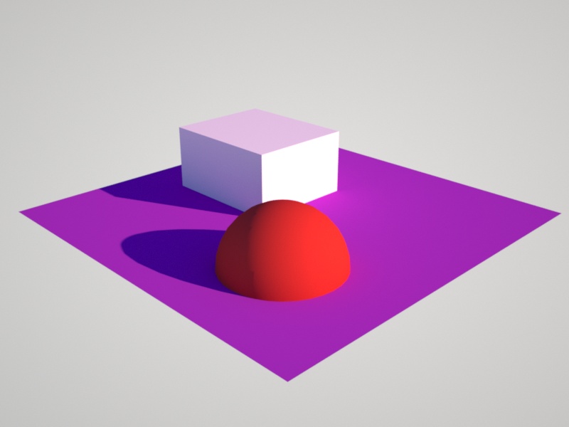

I think Norman was asking specifically about the Render Layers, not really the passes. He wants to render Render Layer 1 and Render Layer 2 at the same time, but they'd go into different layers once in photoshop - all with an EXR. So it makes masking easier. This is somewhat related to my post (unanswered) about Render Layers and that they show through to the background on their edges.

1. Thanks paride, it's not exactly what i ask about :) I gave photoshop as an example for "all layers in one file" workflow. In reality I work with sequences of exr's in after effects. For exr extraction in After Effects should I set up the same options in exr config windows as you provided in photoshop case? In example above, render elements are here not necessary, but somehow these are visible on your screenshot. I am interested in layers only. Like first ball is layer 1 beauty, second one is layer 2 beauty and so on, and floor is a layer 5. I need them stacked in after effects as a multi layered composition with acess to each layer independently (similar like in photoshop). No render elements are required here. Just layers.

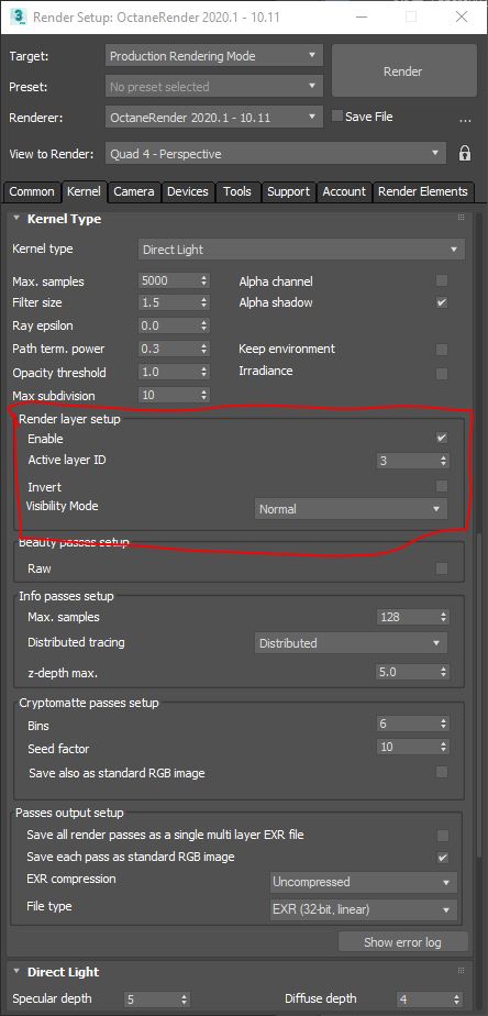

Cyptomatte is the best method for getting out mattes to control your compositing. If you need to render out a specific object(s) with all the raytracing effects from your surrounding, but keep your surrounding matte black, activate Render Layer Setup.
Details on how to use it can be found in the manual here -
https://docs.otoy.com/3DSMaxH/3DSMaxPlu ... Layers.htm
