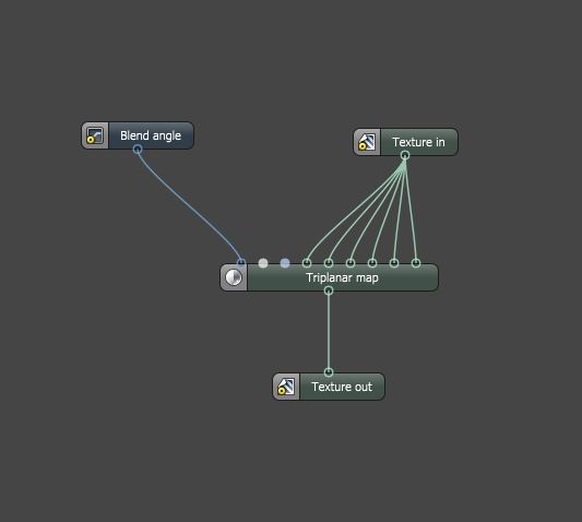

Just create a group with the triplanar node inside it that makes it easy, see attachment for the basic setup. Then you can just copy it around.

Thanks. I don't use standalone, or a node based material editor for a number of reasons. Regardless, that only(kind of) addresses one of the many shortfalls.
