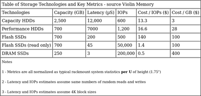

Will SSD Drive speed up meshing / importing significiantly?
It's maybe a little bit older, but it should give you a guide...
