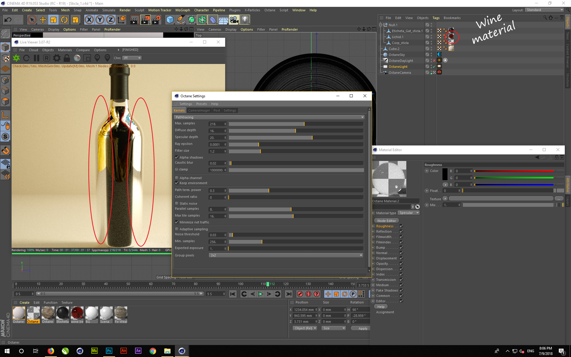

Hello guys!
I'm trying to make a bottle of wine in Cinema 4D using Octane Render.
But I have a problem, I use the Octane material set on Specular, OctaneSky (HDR image) and OctaneDayLight are the sources of light, but the reflection on my object is not what I need. There are two too strong reflections on the edges of the bottle and the liquid becomes black although it should be dark red.
How can I get beautiful glass reflexes and not be those two bands of reflection on the edges of the bottle?
Thank you in advance for your time and apologize for the google translate english

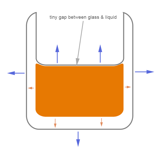

how do you have modelled the glass and the liquid?
Take a look at this picture for the correct solution:
Or slightly intersect the glass and the liquid for a correct result.

Thanks bepeg. The bottle is made of an extruded disc, practically not thick. Could this be a reason why those metal edges should appear? Reflections are set to somewhere at 0.7, 0.8 and the index (IOR) is 1.2.
Still, I do not understand where I'm wrong, at least if I could make those metallic reflections more transparent, see the liquid
Posts: 10618
if the glass has no thickness, it reacts like a solid magnifying lens.
You need to add the thickness like in real life, and overlap the liquid, or follow the above modelling scheme.
ciao Beppe
