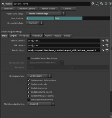

Hi i have a problem with the export from octane.
I click Render to Disk but wen the renders start only the first image gets export
any ideas ?

What happens after rendering the first frame? Do you get an error message or something like that? If you enable the Octane log file in the plugin options panel, you could get more information about what has happened with the rendering session.
The first thing to check is if the scene cannot be rendered in "Update Scene" mode, something that can happen if the any of the scene objects has a non-constant topology along the animation. In this case, you must configure the render mode in "Full Scene Reload" to render the sequence.
If you want to attach the log file or send me the scene, I could check it here.
Thanks,
-Juanjo

I have change Update Scene" mode, to "Full Scene Reload" mode and is now rendering all the images

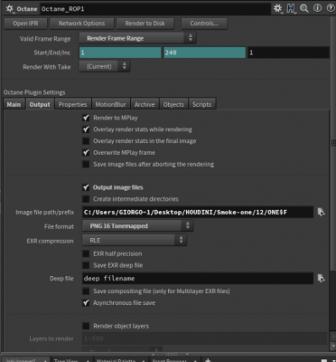

Hi, I have the same problem as giorgosg12. Specifically, if I render to disk, the first frame fully render (all samples) in Mplay but the render bar gets stuck close to the end in the render to disk progress window. Also, the first frame is only rendered in Mplay but it doesn't get saved to disk. I tried to switch to full scene reload but it didn't fix the problem.

Hi, earlier I sent the scene and logs by DM. However, in the meantime I updated to the latest Houdini version and the latest Octane plugin version and that seems to have solved the issue.
