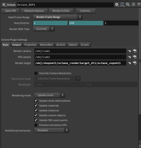

Hi i have a problem with the export from octane.
I click Render to Disk but wen the renders start only the first image gets export
any ideas ?

What happens after rendering the first frame? Do you get an error message or something like that? If you enable the Octane log file in the plugin options panel, you could get more information about what has happened with the rendering session.
The first thing to check is if the scene cannot be rendered in "Update Scene" mode, something that can happen if the any of the scene objects has a non-constant topology along the animation. In this case, you must configure the render mode in "Full Scene Reload" to render the sequence.
If you want to attach the log file or send me the scene, I could check it here.

I have change Update Scene" mode, to "Full Scene Reload" mode and is now rendering all the images
