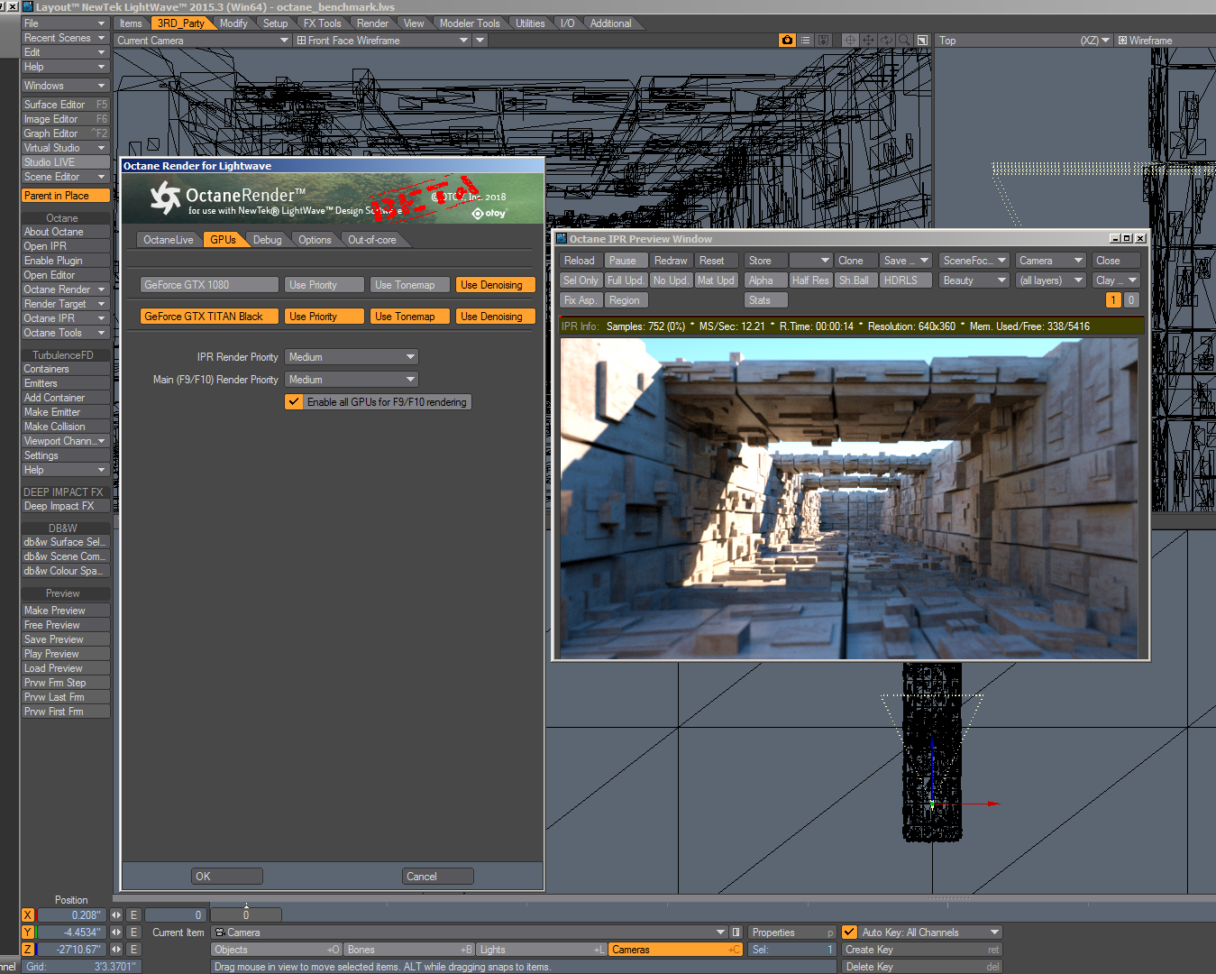

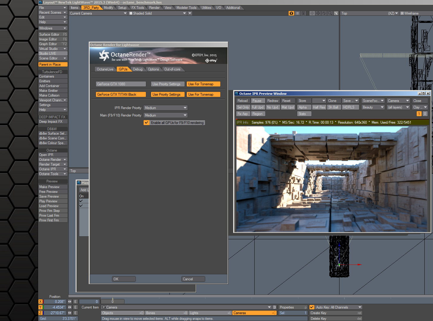

What error do you get? Perhaps the problem is that you don't have this GPU enabled for tonemapping, and at least one must enabled to see the rendering in progress.

Well I did what you said and checked everything
it was working with both cards?
hmmm
Still cant seem to get it to work with both cards

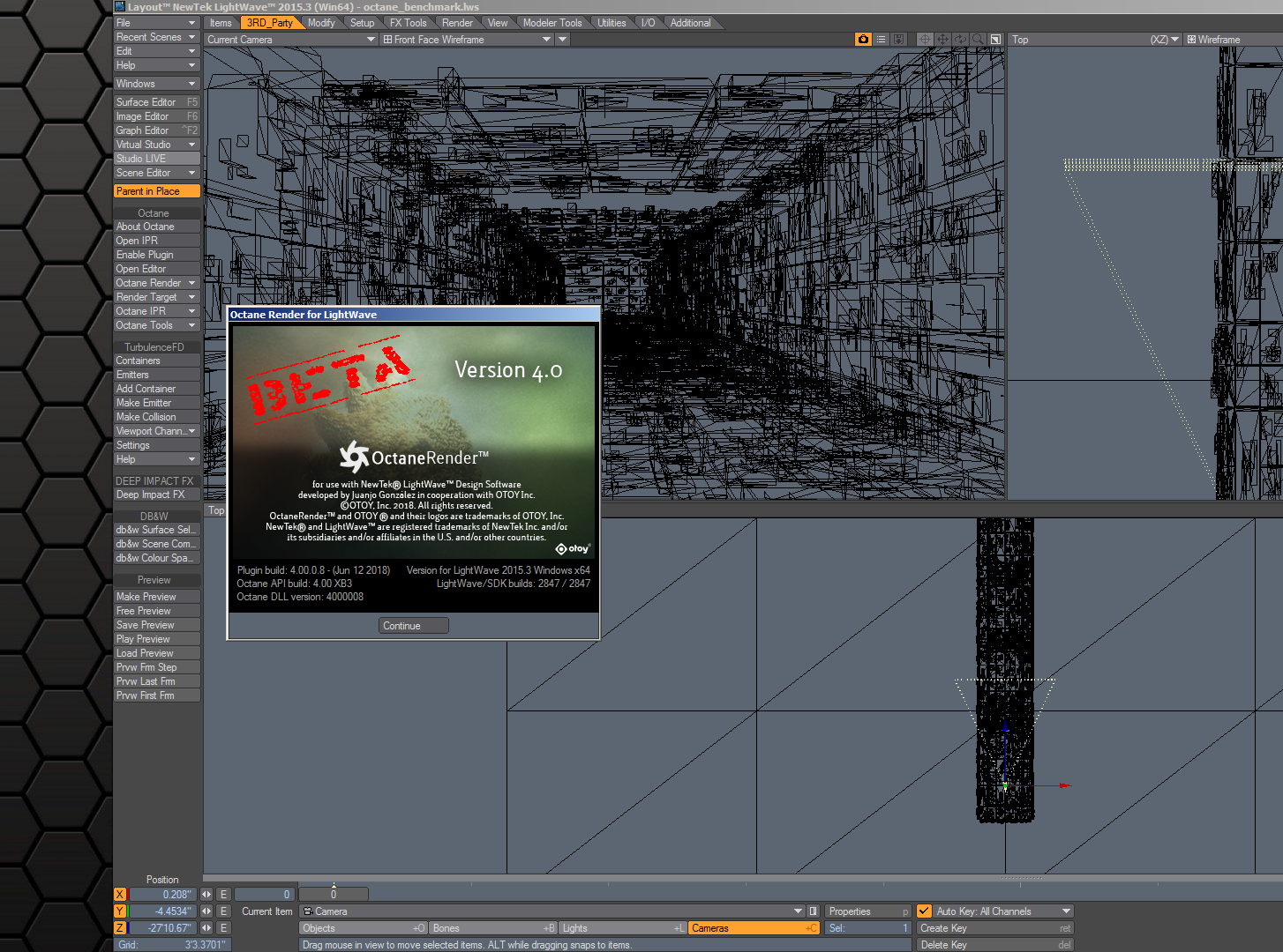

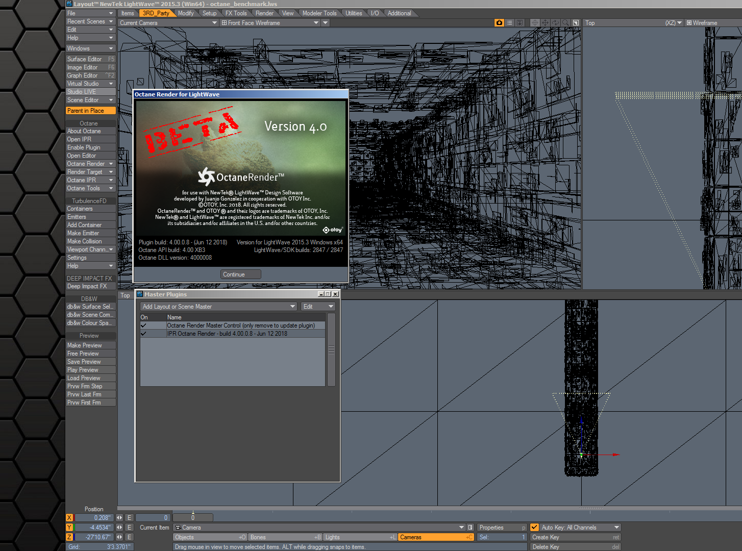

Ok I loaded the 4.00.0.8 version plugin..
everything works except when I try to use the GTX-1080 card..
works fine with the Titan - Black ???

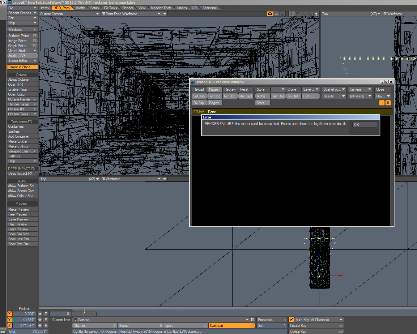

Image 8 is the error I get " RENDER FAILURE: the render can't be completed. Enable and check the log file for more details."
I looked at the log file and well did not see any thing??

3dcgmodeler wrote:Ok I loaded the 4.00.0.8 version plugin..
Mike
mike
take it off...
hope it helps...
snip lwguru

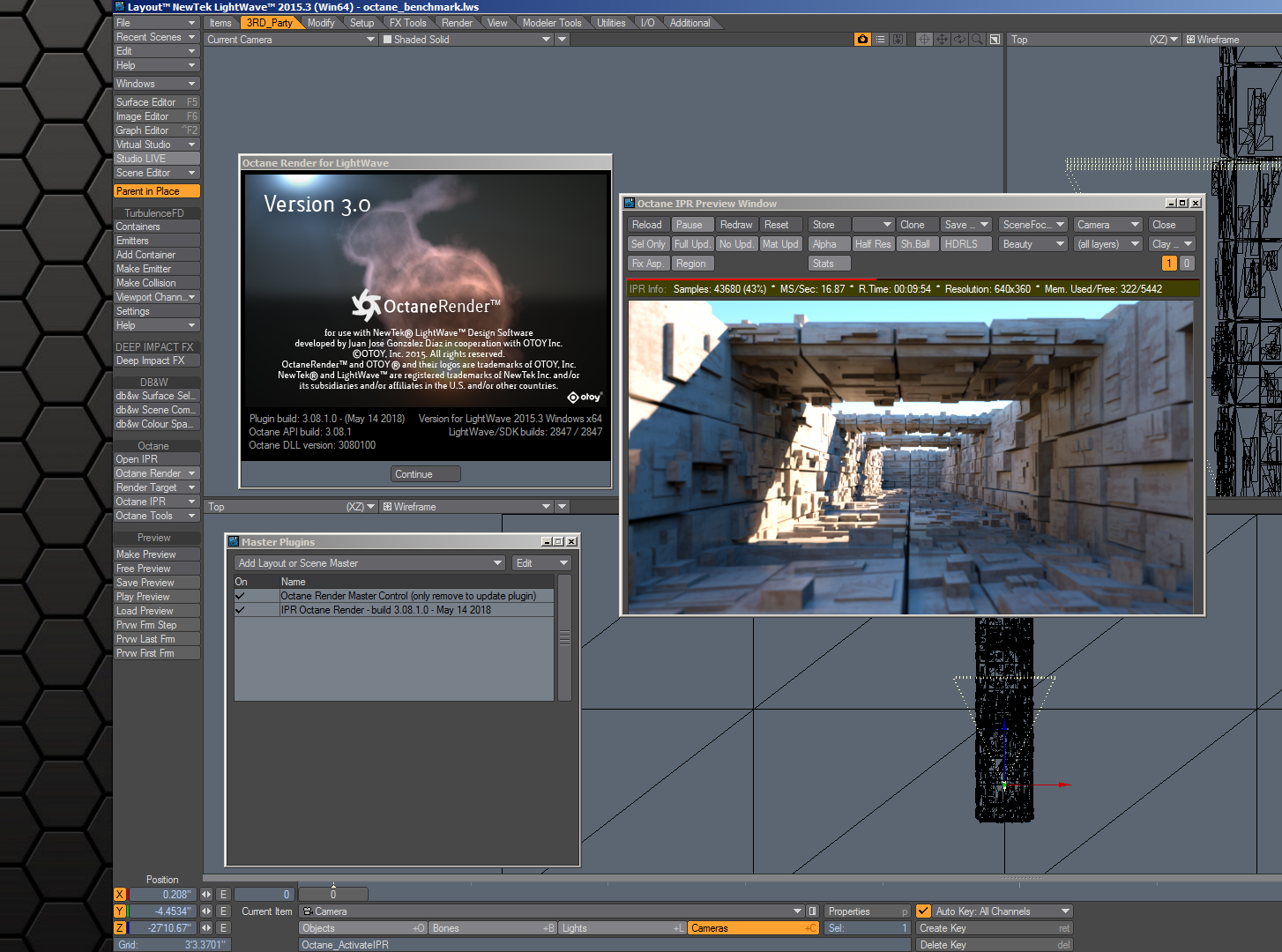

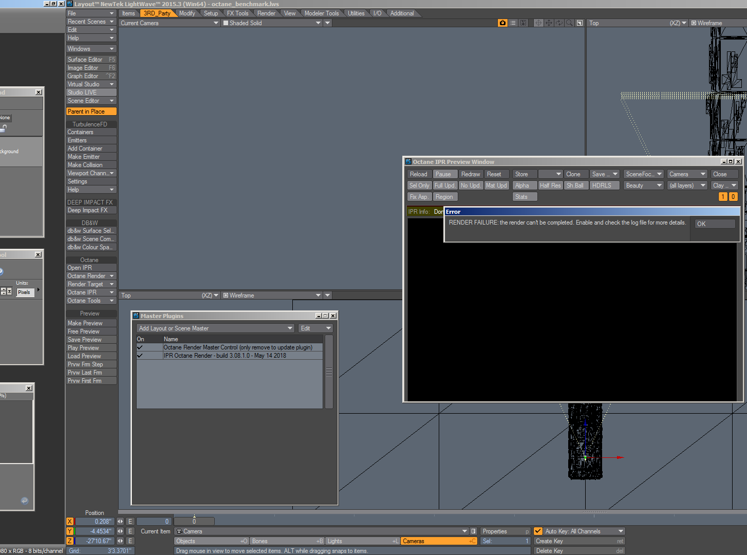

I am back to using the 3.08.1.0 version the 4.0 don't work either??

So in short, you say that none Octane 3.08 or Octane 4.00 work with your two GPUs enabled, right? Well, it is really a weird issue that must be system related for sure, because I don't have other reports about problems like that using multiple GPUs.
Do you know if Octane Standalone has the same problem while trying to render using the two GPUs?
