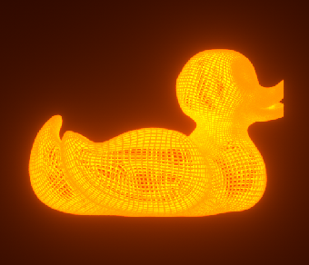

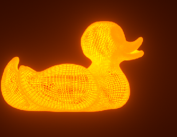

frame 2
frame 2
CINEMA 4D_2018-06-18_08-35-39.png (118.39 KiB) Viewed 1011 times
frame 1
frame 1
CINEMA 4D_2018-06-18_08-35-32.png (119.14 KiB) Viewed 1011 times
No matter what I tried, my object(s) keep getting cut off when I try to render an animation. The ducks are simply moving forward...
Tried new drivers, reinstalling Octane, different versions... I'm completely clueless what to do.

Wow you might actually be right, I turned on Render Instances in the cloner with the ducks and now it works..?
