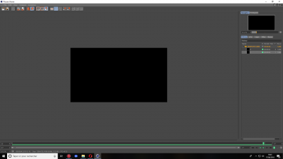

Hello, i have a problem since today my octane won't render any animate scene i try.
I already check the polygons count , it's ok
updated my 2 1060 OC 6GB to the last driver
I tried everything that this forum was proposing relative this problem...
If someone can save me...
Octane log :
CUDA error 719 on device 1: unspecified launch failure
-> could not get memory info
-> failed to deallocate device memory
-> failed to unload module
CUDA error 719 on device 0: unspecified launch failure
-> failed to bind device to current thread
device 0: failed to initialize context
device 1: failed to initialize context
CUDA error 201 on device 1: invalid device context
-> failed to create link
device 1: failed to create OSL compile context:
device 1: failed to compile module 0
CUDA error 201 on device 0: invalid device context
device 0: failed to create OSL compile context:
device 0: failed to compile module 0
Thanks a lot

Test it without materials! Probably you have C4D shaders, right?
