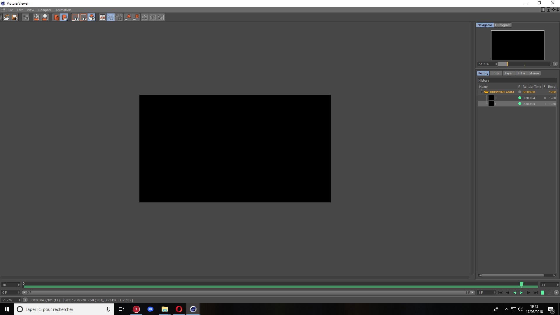

Hello, i have a problem since today my octane won't render any animate scene i try.
I already check the polygons count , it's ok
updated my 2 1060 OC 6GB to the last driver
I tried everything that this forum was proposing relative this problem...
If someone can save me...

Test it without materials! Probably you have C4D shaders, right?
