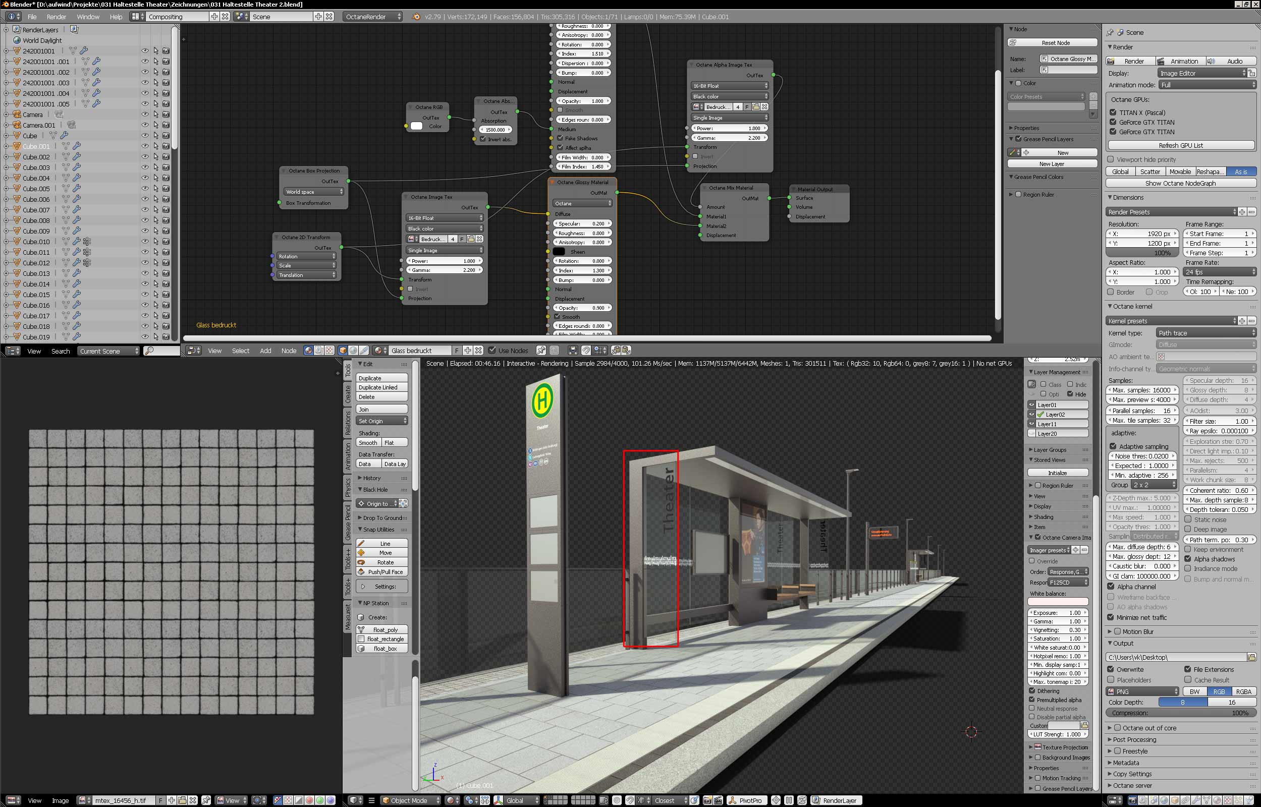

I have some problems with "affect alpha" of the specular material. It was working in 3.07 and is working in the standalone Version 3.08.
In Version 15.2.4 it will give only correct results after unchecking and checking the option again. But when start rendering again it will give wrong results again.
affect alpha - wrong
affect alpha - correct (after unchecking and checking again "affect alpha")

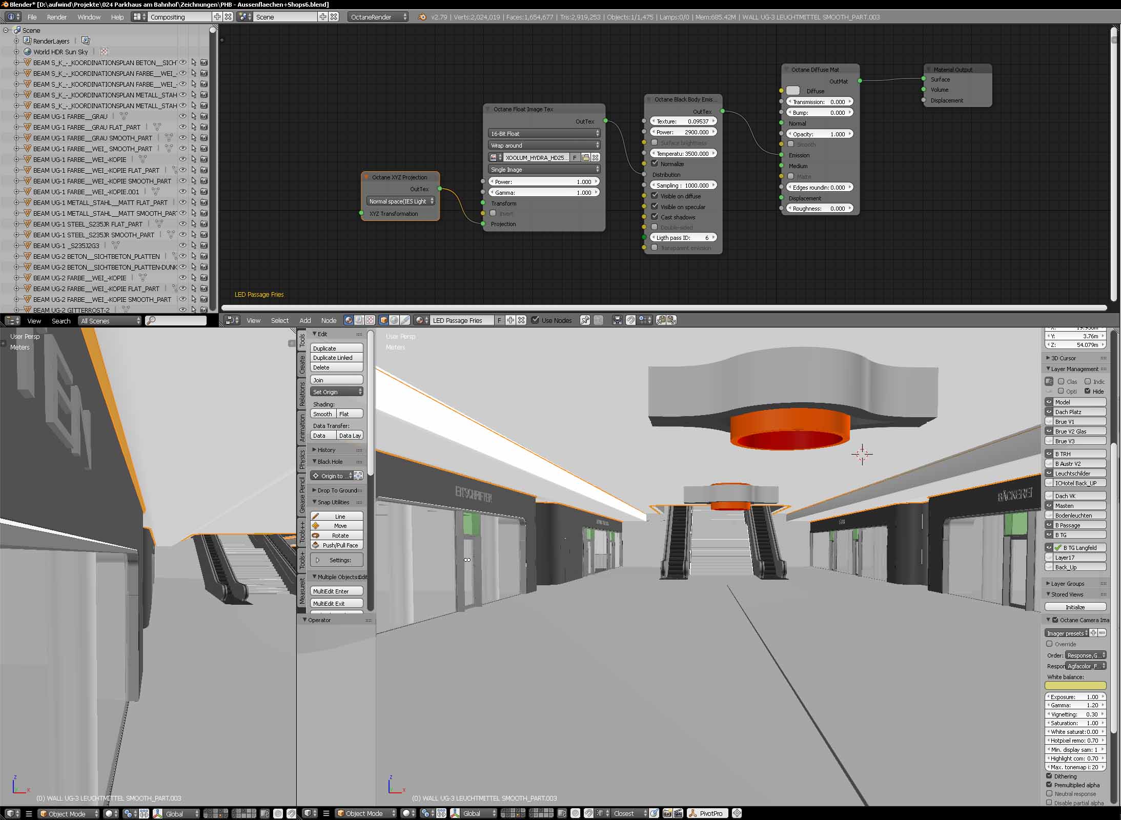

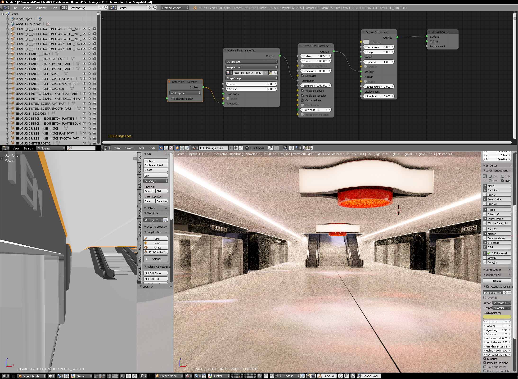

at least the enum properties of the projection nodes are in the wrong order.
Former Value 2 (ies light) is now opened as world space. Which breaks backward compatability.
What's even worse when in rendering mode, the properties will switch (world space in object mode is ies light in render mode).

attached a Scene with a simple ies light. It has been created in the 3.07 14.0 Blender Plugin Version.
The XYZ Projection is set to Coordinate Space 2, which will open in Standalone 3.07 and 3.08 as supposed to "ies light".
When opening the Blend File in Version 15.2.4 it will show and render wrongly in "World Coordinate".
The reported switching issue happens in another scene which i can't upload.
The Scene was created in Blender Plug-In Versions from probably 2.78 - 2.79.
When opening all the IES-Projections are (as reported above) wrong. I manually changed the projection in object Mode to IES. See below. When hitting Render the changed Projection will flip back to the wrong World Coordinates!?
