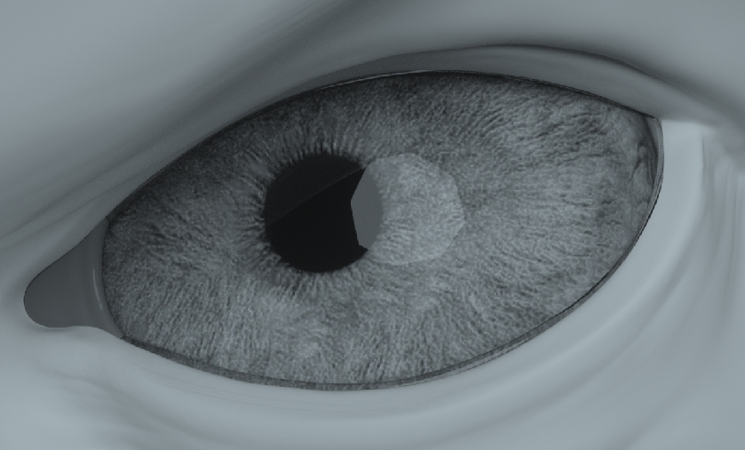

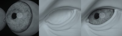

Hi I'm currently working on the eyes of a character but I got stuck trying to make the little wetness layer that goes between the eye and eyelid to make it blend a bit better.
Whatever I try to do the little tear line always turns out too dark giving me a weird result that I can't use.
Even when I set the opacity in the specular material all the way too 0 the black shadow of the object still remains.

note the slim black mesh going around the eye with the tiny specular

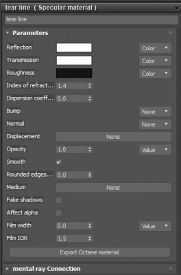

There's images attached that show the difference + an image of how my specular shader is set up at the moment, maybe I'm doing it completely wrong for all I know.

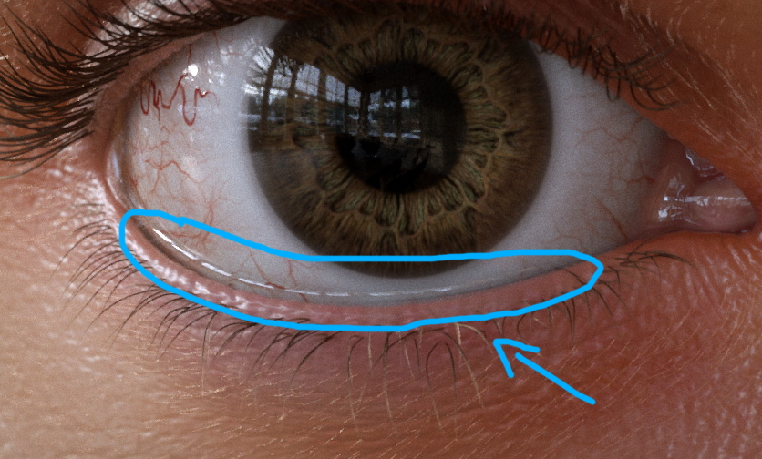

I had checked out those two posts and the post from Rikk The Gaijin shows it should be possible as he absolutely nails it: download/file.php?id=33472&mode=view

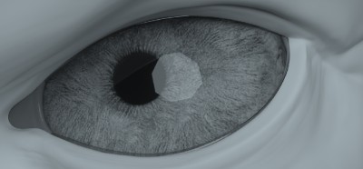

Rendered without tear line
Rikk nailed it!
Rikk nailed it!
My current tear line specular setup

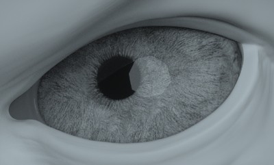

rendered with DMC
rendered with DMC

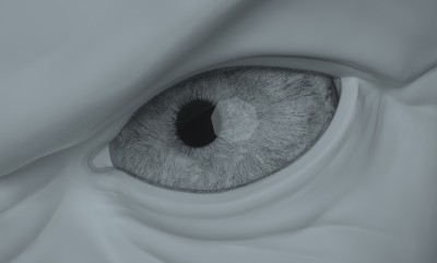

Rendered with path tracing

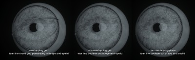

Just did a small test rendering the different meshes I created for the tear line with just the eye and nothing else.
I think the plane works best for what I'm trying to achieve but as soon as I introduce the head again I get the same weird results.

Did another small test to see what could be causing the issue.
This time I used the plane geo and checked it with just the eyeball, then just the face and then all of them combined.
I'm starting to have the feelin that the issue is caused from the tearline being too round and reflecting a little like chrome would resulting in these weird heavy shaded edges.
I will keep updating this thread as I go but if anyone has some more information on what it could be please don't hesitate to let me know!

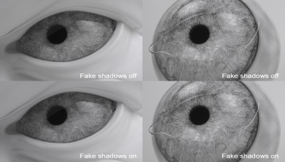

I would try to enable the Fake shadow in the Specular material, use an HDRI for lighting, and slightly overlap the geometry.
Note that you don’t have white behind your lacrima, so the effect is different from the Rikk reference.

Hi Beppe,
Thanks for the input!
I've set up and HDRI and tried enabling the Fake shadow parameter in the spec material but it makes very little difference.
I also think that the white behind the tear line is not the problem.
As you can see in the comparison image the side where I hide the face has the tear line rendering fine without darkening what is behind it, but as soon as the face is included the tear line darkens.
