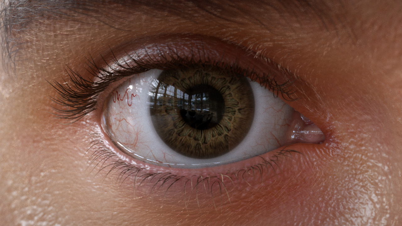

this is what I am trying to achieve (where it says tear line):
http://www.therookies.co/wp-content/upl ... wal-01.png
the most common technique to achieve this is to do something like this:
https://us.v-cdn.net/5021068/uploads/ed ... 9glk6y.jpg
https://i.pinimg.com/originals/44/ba/de ... 6b69b9.jpg

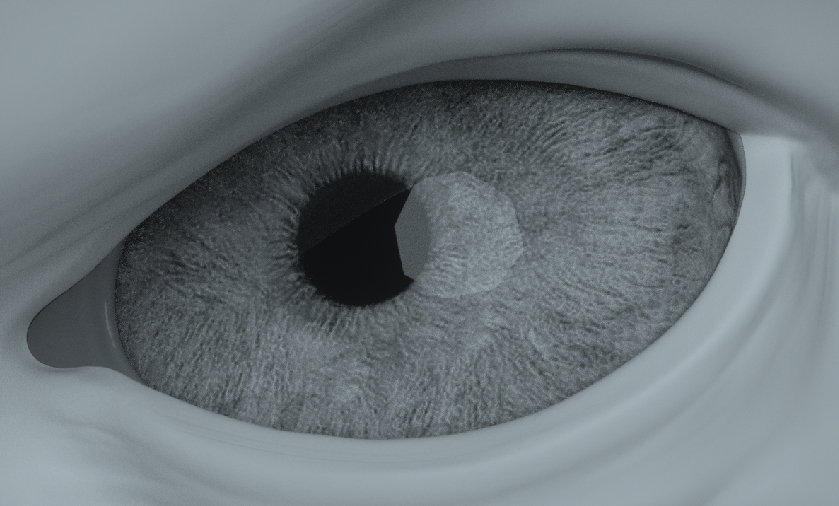

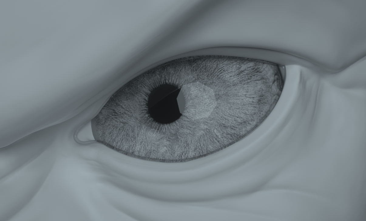

I tried using both PMC and path tracing but it makes very little difference.
There's images attached that show the difference + an image of how my specular shader is set up at the moment, maybe I'm doing it completely wrong for all I know.
I had checked out those two posts and the post from Rikk The Gaijin shows it should be possible as he absolutely nails it: download/file.php?id=33472&mode=view
I'm wondering what I am doing wrong as I can't figure it out, I hope you have a better understanding.

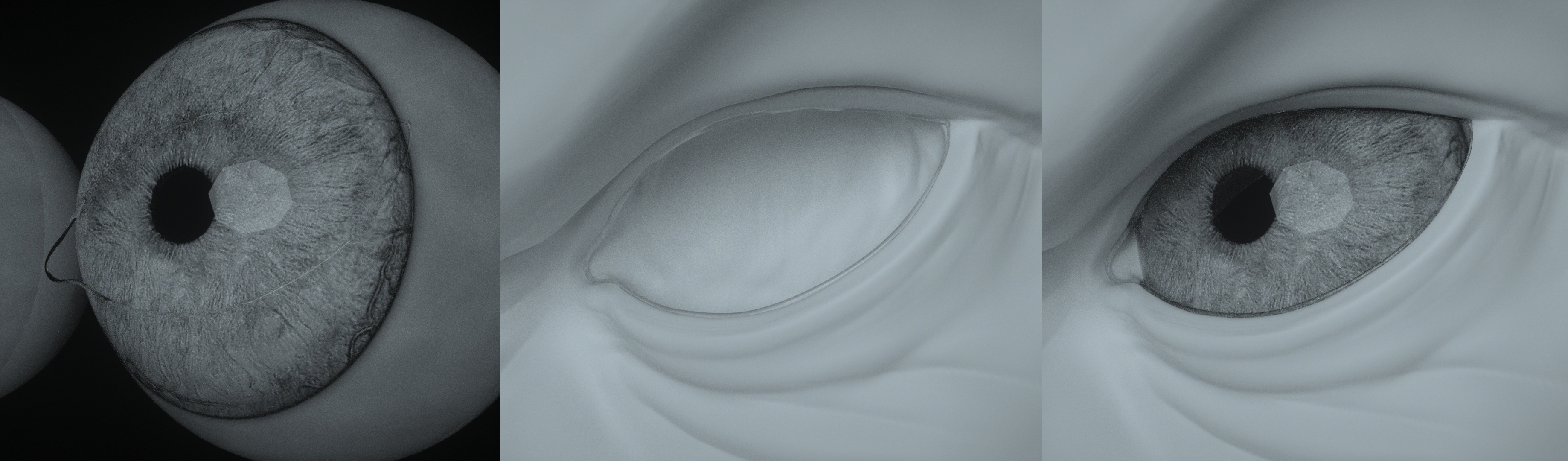

Just did a small test rendering the different meshes I created for the tear line with just the eye and nothing else.
I think the plane works best for what I'm trying to achieve but as soon as I introduce the head again I get the same weird results.

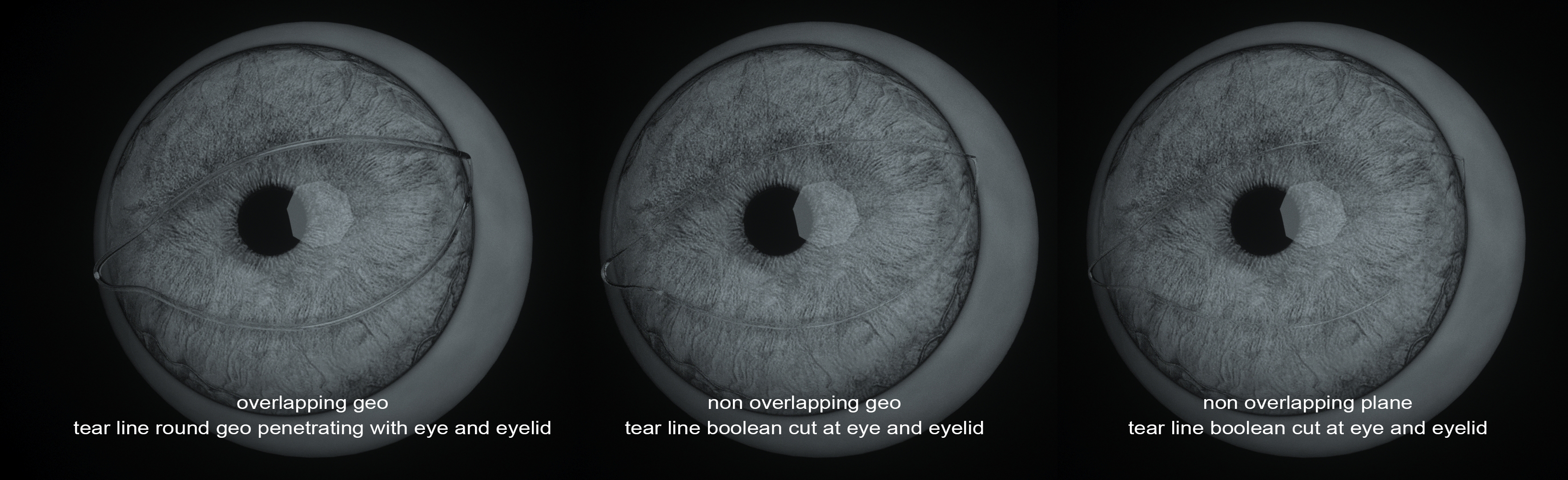

Did another small test to see what could be causing the issue.
This time I used the plane geo and checked it with just the eyeball, then just the face and then all of them combined.
I'm starting to have the feelin that the issue is caused from the tearline being too round and reflecting a little like chrome would resulting in these weird heavy shaded edges.
I will keep updating this thread as I go but if anyone has some more information on what it could be please don't hesitate to let me know!

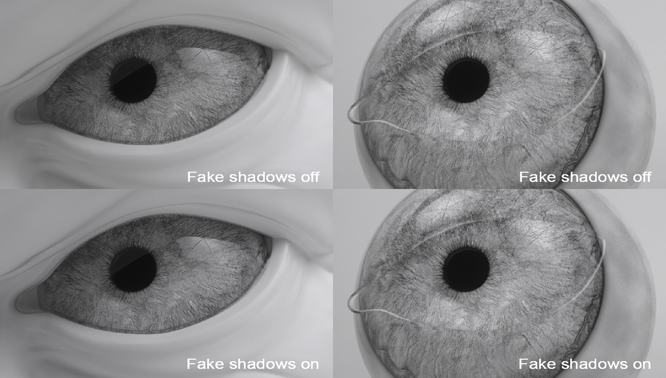

Hi Beppe,
Thanks for the input!
I've set up and HDRI and tried enabling the Fake shadow parameter in the spec material but it makes very little difference.
I also think that the white behind the tear line is not the problem.
As you can see in the comparison image the side where I hide the face has the tear line rendering fine without darkening what is behind it, but as soon as the face is included the tear line darkens.
Cheers,
J
