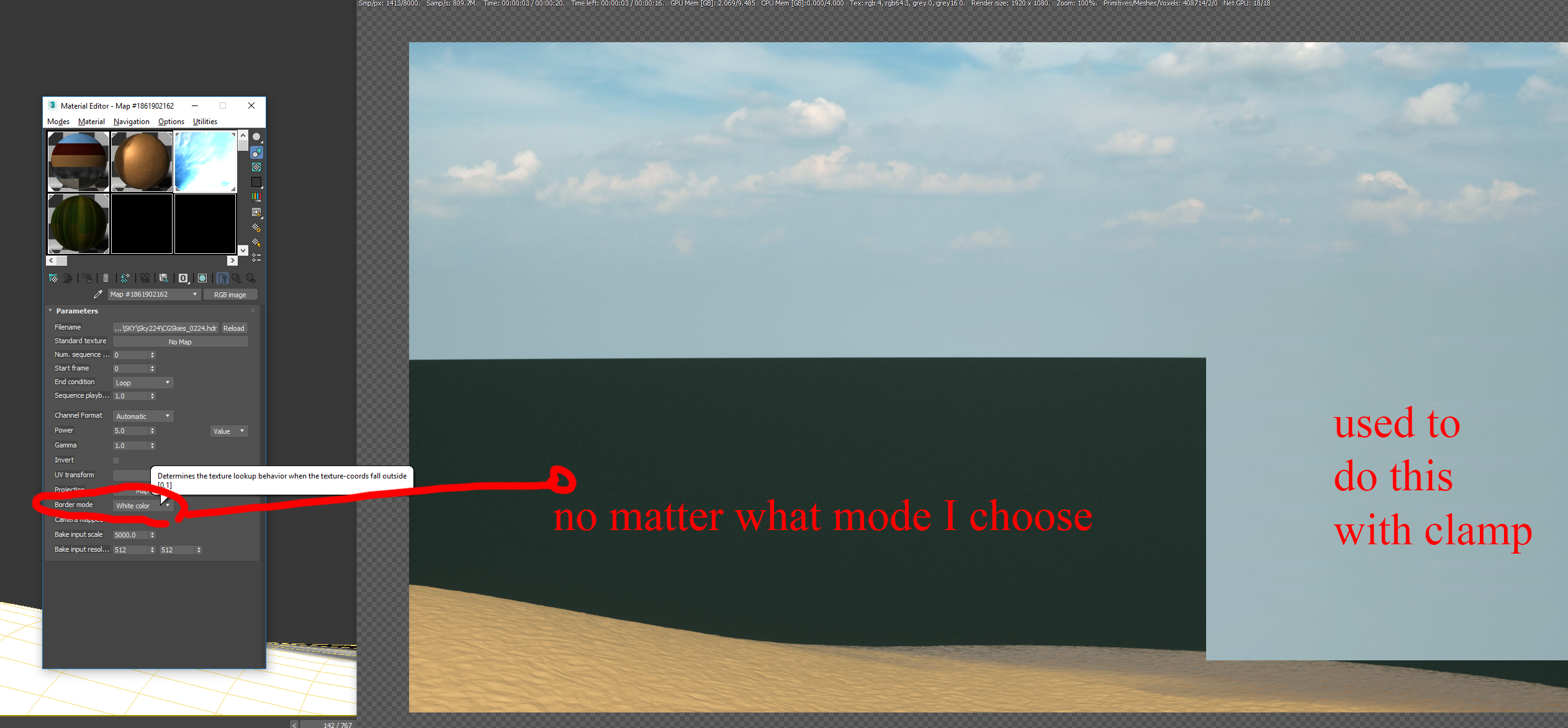

Hi It seems that border modes do not work anymore They are always black even if I choose clamp, white, mirror etc. used to work in earlier versions Thanks

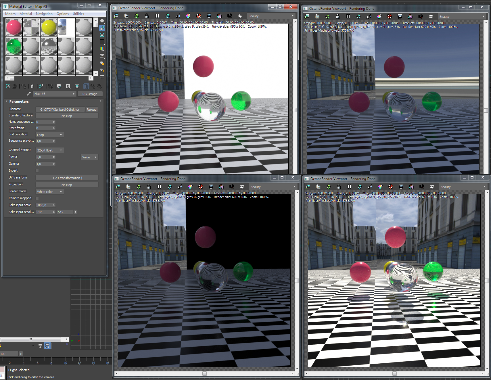

Hi coilbook,
it seems everything works, any ideas?

Hi Paridie,
I sent you the file with HDRI sky in PM
it still does n't work for me
Thank you
paride4331
Posts: 3929
Hi coilbook,
I tested your file, the issue happens creating environment in 3dsMax 2019.
Creating environment using 3dsMax 2018 (e.g) and using it in 3dsMax 2019 everything seems to work.
I sent this issue to developers.
Paride

Thanks. By the way, this was created in 2018.4 and I am only using 2018.4
paride4331
Posts: 3929
Hi coilbbok,
you're definitely right, I'm wrong, I was misled creating a new OctaneDaylight but using an Octane plugin earlier than 5.08.
Regards
Paride
