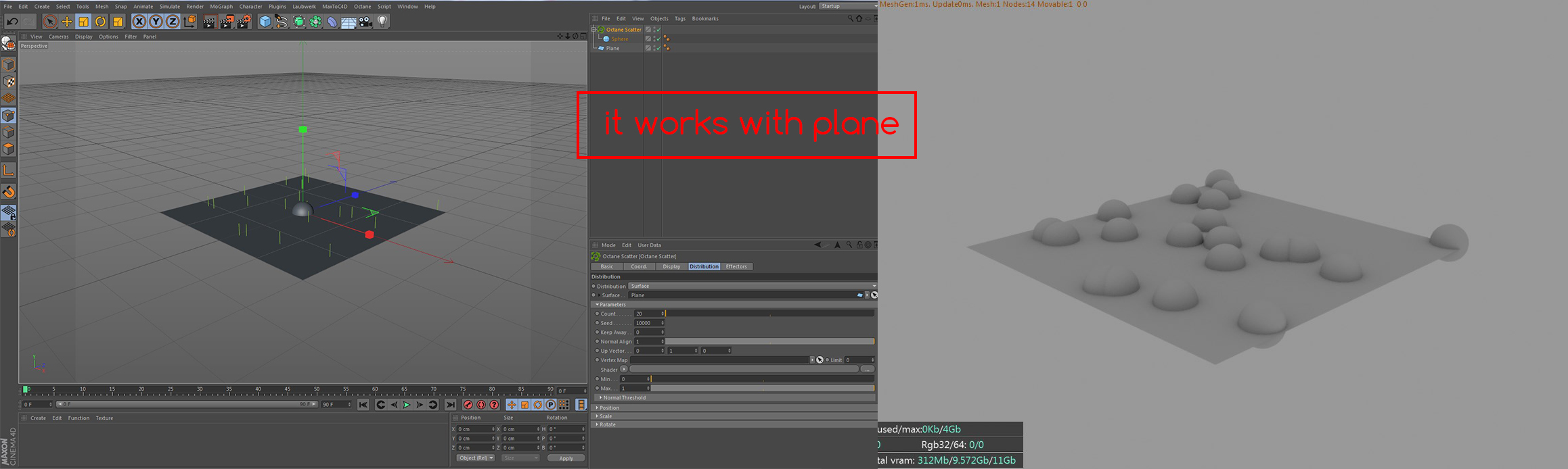

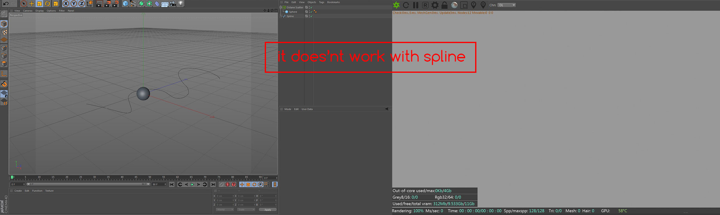

Hello, i updated my Cinema 4d. Now im using the latest version. But when im using "scatter", spline tool doesn't work.
ps. My version is Cinema 4d R15

medyatikfikir wrote:Hello, i updated my Cinema 4d. Now im using the latest version. But when im using "scatter", spline tool doesn't work.
Did scatter ever work with a spline? The entry under Distribution is specifically called, "Surface."
One simple way to do it would be to sweep a small triangle n-side spline down your primary spline, then use the resulting surface for the distribution surface.
